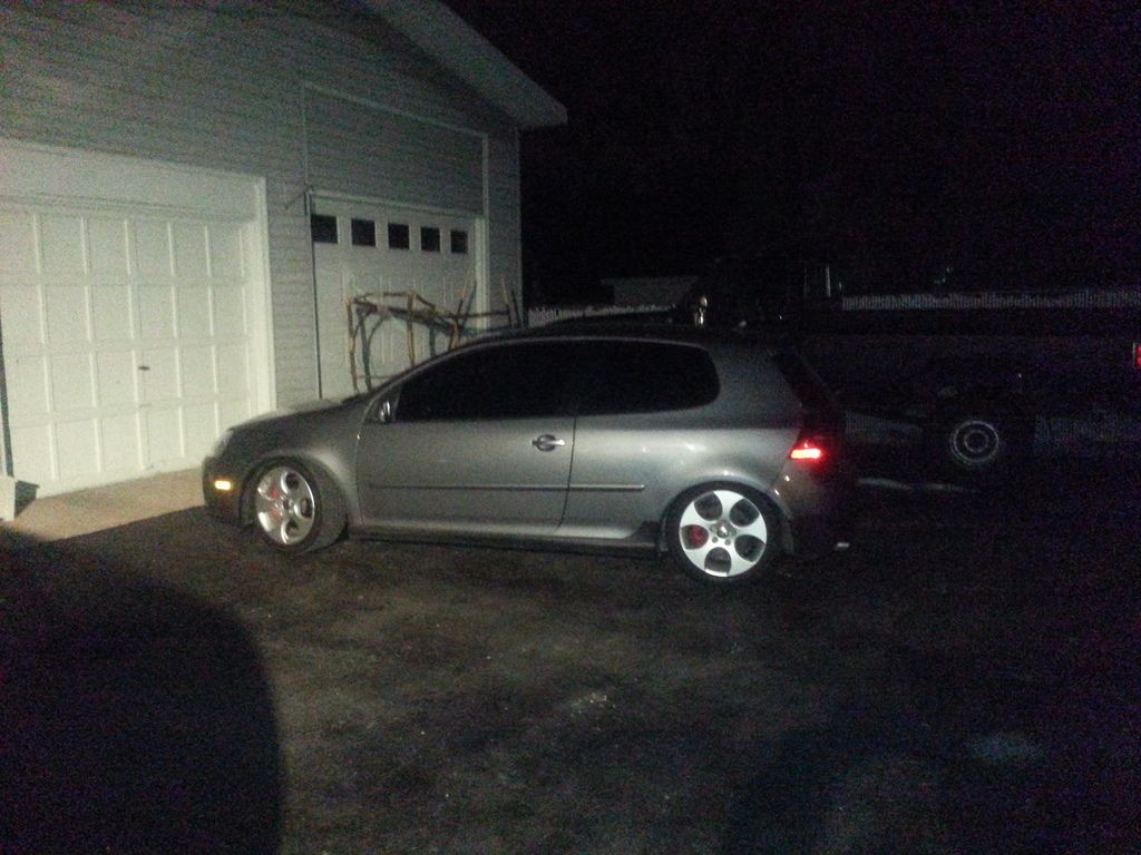

The day I brought her home.

Less than 24 hours and I couldn't control myself. I have a pretty decent parts bin to pull from and hated the wheels that were on it. It's a daily so it needed a roof rack as well.
