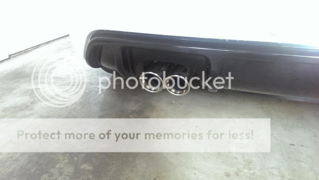

Autotech had a sale on their catback, so I decided to pick one up.

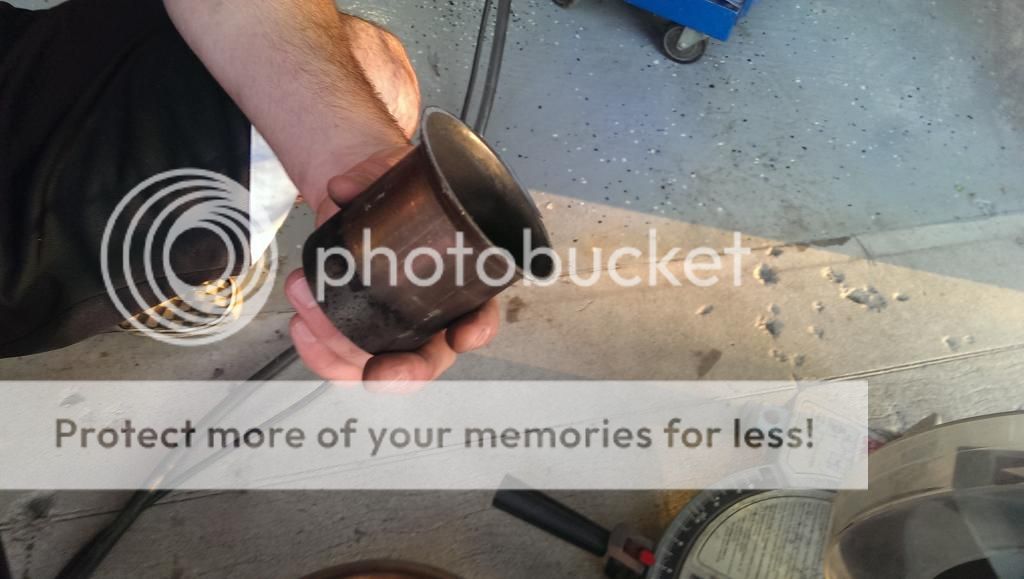

Threw it on a for a day, and decided that the stock 2.6" reduction at the end of my downpipe and the start of this new catback wasn't going to cut it.
With the help of eurocars (once again), the recution was chopped the fuck off:
A V-Band was welded on:
We also made a slip-fit to V-band adapter to keep the whole system modular with the APR downpipe.
Overall I'm really happy with the sound the car makes. It's definitely loud, but it has drowned out the clutch and motor mount noise.
Now comes the endless struggle of trying to keep these tips clean.
