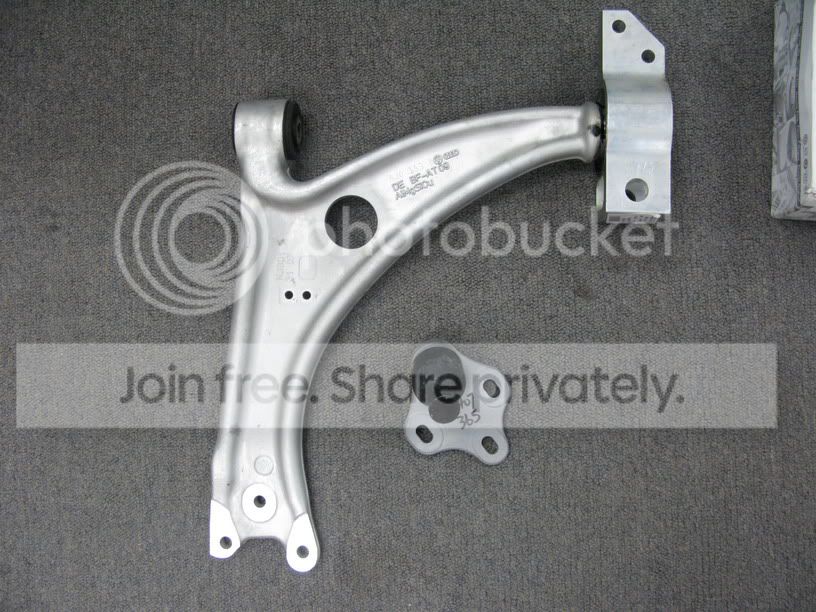

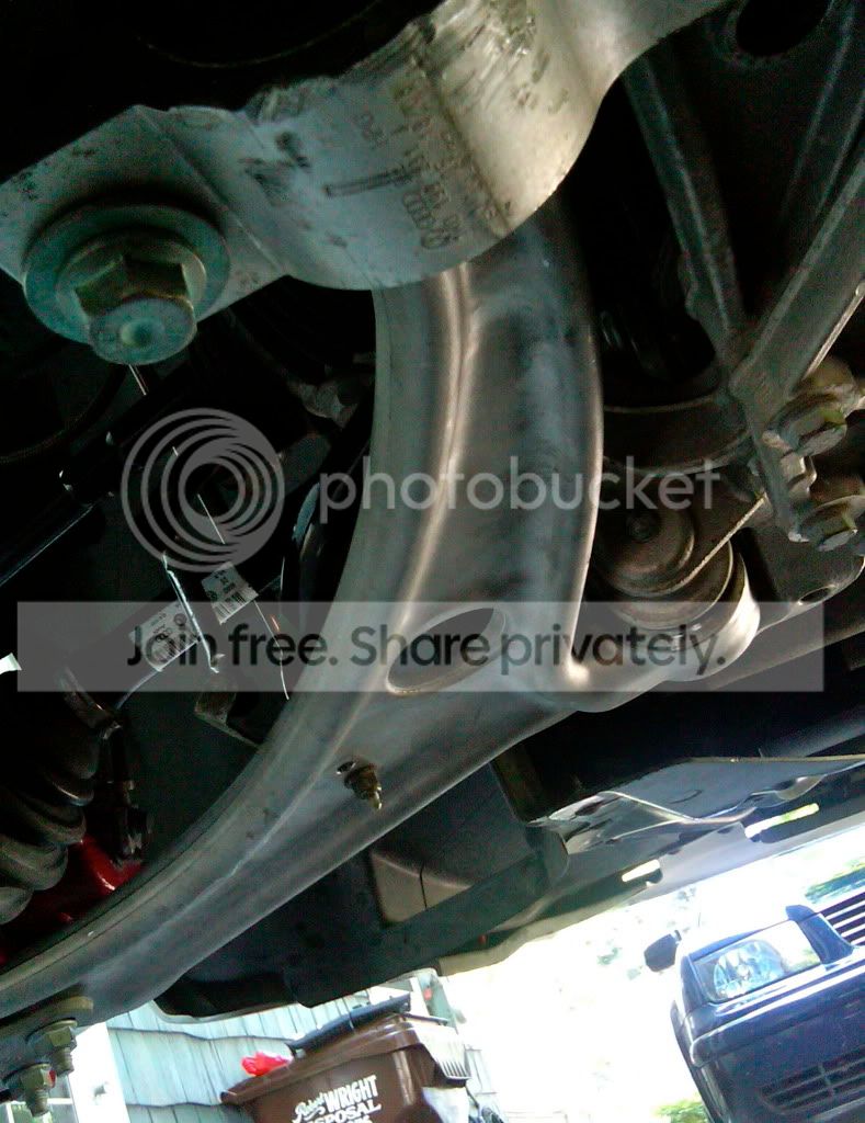

I recently installed a set of Audi TT aluminum control arms on my car after reading about this mod on the UK boards. This mod provides for a number of enhancements over the stock set up and the results are nothing short of amazing. For me this is the single most significant chassis performance mod in terms of decernable handling improvements. Turn in response is incredable and the car feels as if it's on rails through fast sweeping curves.
Benefits of these arm include:
- Lighter (unsprung) weight; 5 lbs vs 9 lbs per arm.
- Higher center of roll as explained in the attachent below.
- Stiffer solid bushings which improves feel and reponse.
- Finally and most significantly, ajustable front camber.

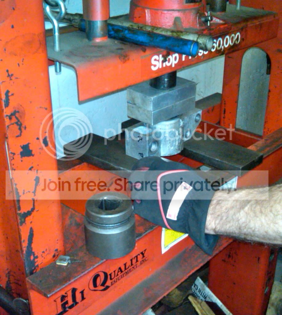

Cost of parts isn't exactly cheap and you will need to make use of a hydraulic press to swap out the rear bracket bushings but the rest of the installation is simple and straight forward.

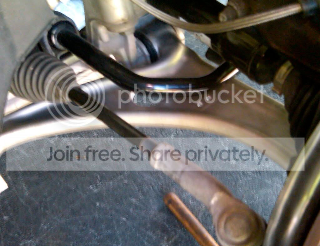

Finally a few images:
(Borrowed photo)

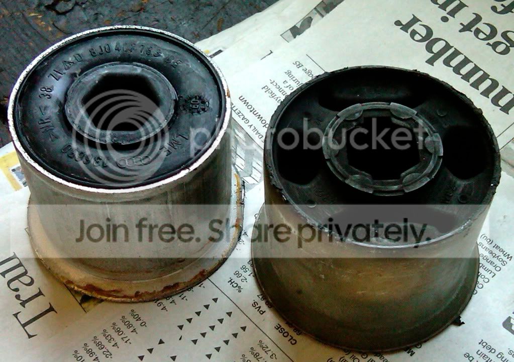

TT bushing on left, OEM GTI on right.
Also check out the information cut from an Audi technical Bulletin that is attached. (full document: Audi TT Suspension

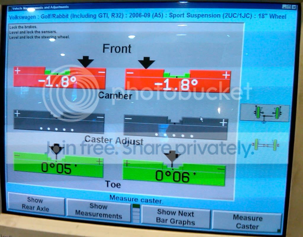

The - 1.8 deg of camber is the most possitive we could get. I know some folks are running -2.0 to 2.5 deg with camber kits and the present setting is the balls for handling but I'll be keeping an eye on inner tire wear. If necessary I may just elongate the ball joint bolt slots to get it a little closer to the -1.5 that I was originally shooting for. You may want to do this off the bat especially if you are running really low.

The day after my original post I went out on a spirited run that included a brief high speed run at an indicated 140 mph and I have to say that the car seems absolutely transformed. The front end is absolutely glued and I will be bringing the rear sway bar out to full stiffness to get the handling on to be more neutral . The increased high speed stability suggests increased positive caster and as such I'm disappointed that the shop didn't record caster. The remaining concern has to do with inner front tire wear and I will be updating this post on that issue. :thumbsup:

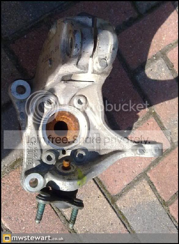

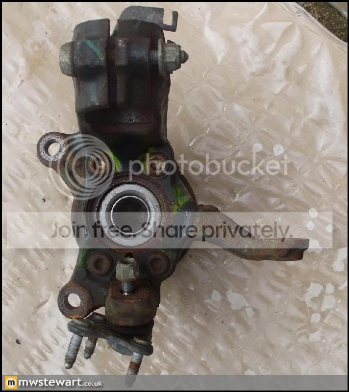

To add some info the Audi s-3 spindles are also alot different .:thumbsup: Bob.G

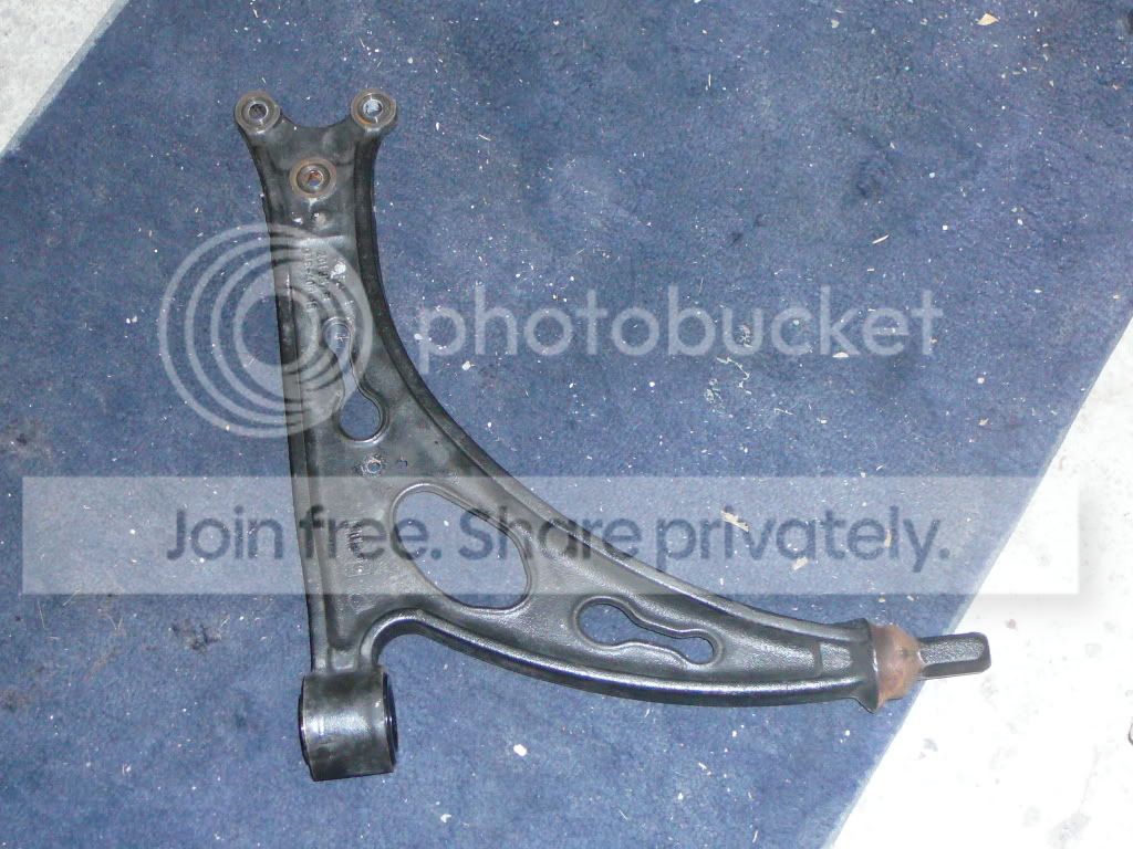

Edit to add Below to compare STOCK cast MKV contol arms

One note on those spindles. The size of the knuckle for the brake caliper is different, IIRC the casting is thicker. So either some modification or different brakes are required.

The Audi TT has 26 mm wider front track compared to the Golf/A3 which is achieved at the swivel bearings or spindles. The control arms are identical in length to the stock steel units. The difference affecting camber setting is in the ball joint bracket design. As I said it would be easy to elongate the mounting slots in order to achieve a more positive camber angle. I'll probably be dong this in the coming weeks as I hate the thought of wearing out my front tires prematurely.
The idea of adding aluminum swivel bearings is very intriguing I must say. Does anyone have the part numbers for these?
