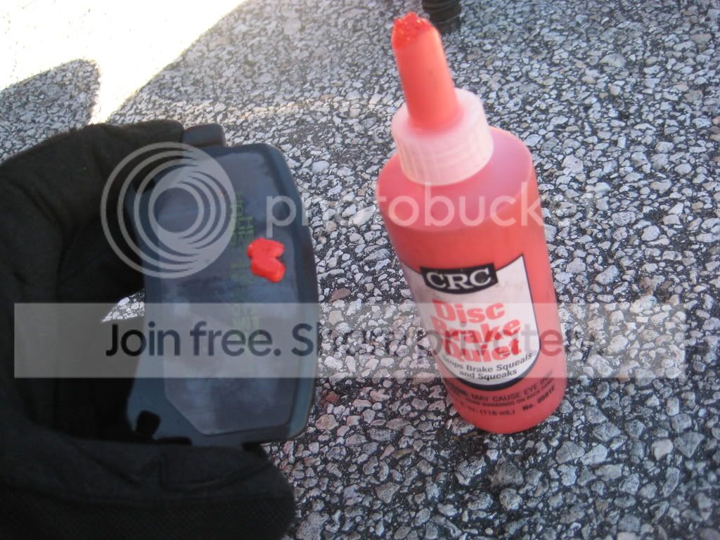

- Anti-squeal paste

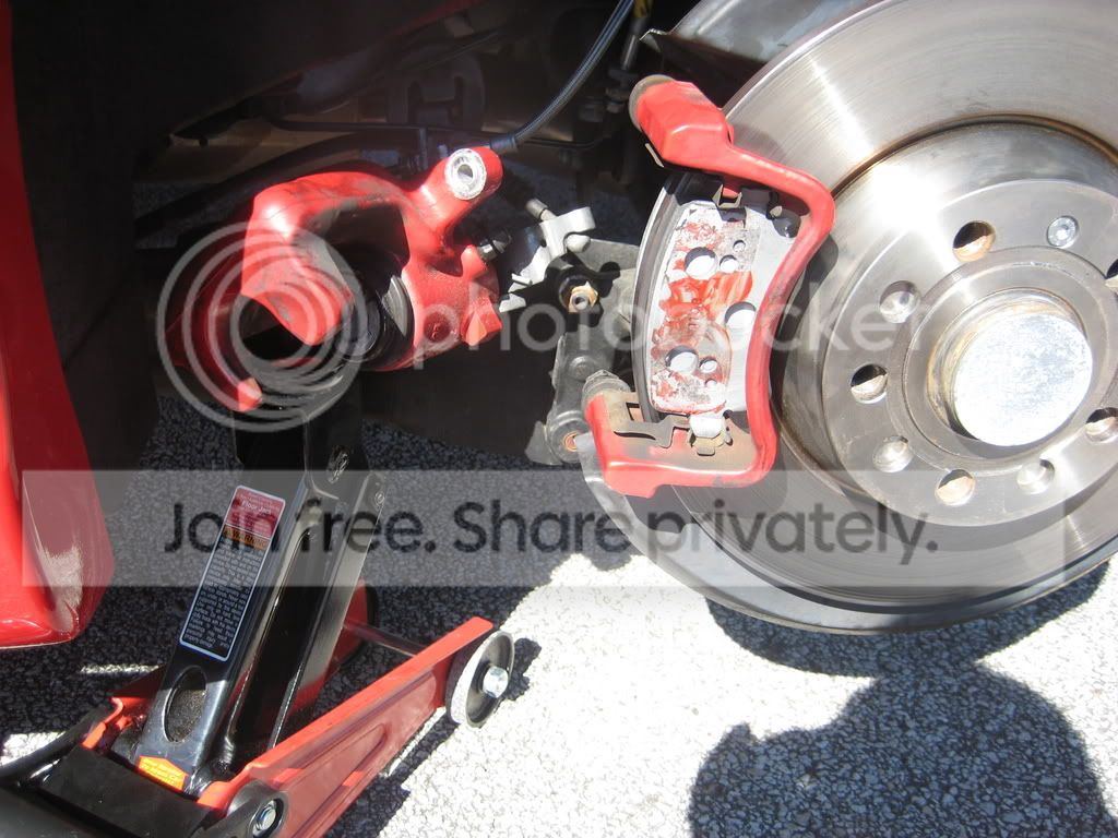

1. Loosen all lug nuts. Jack up car and remove wheels, always use jack stands, NEVER work on a car supported by only a jack

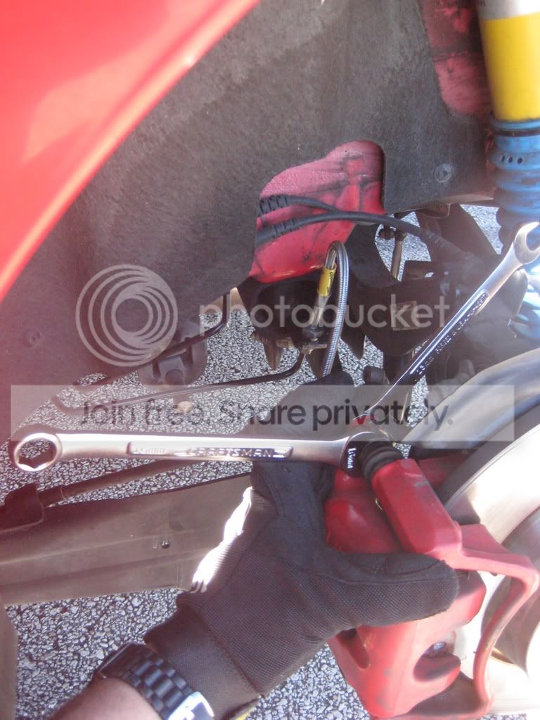

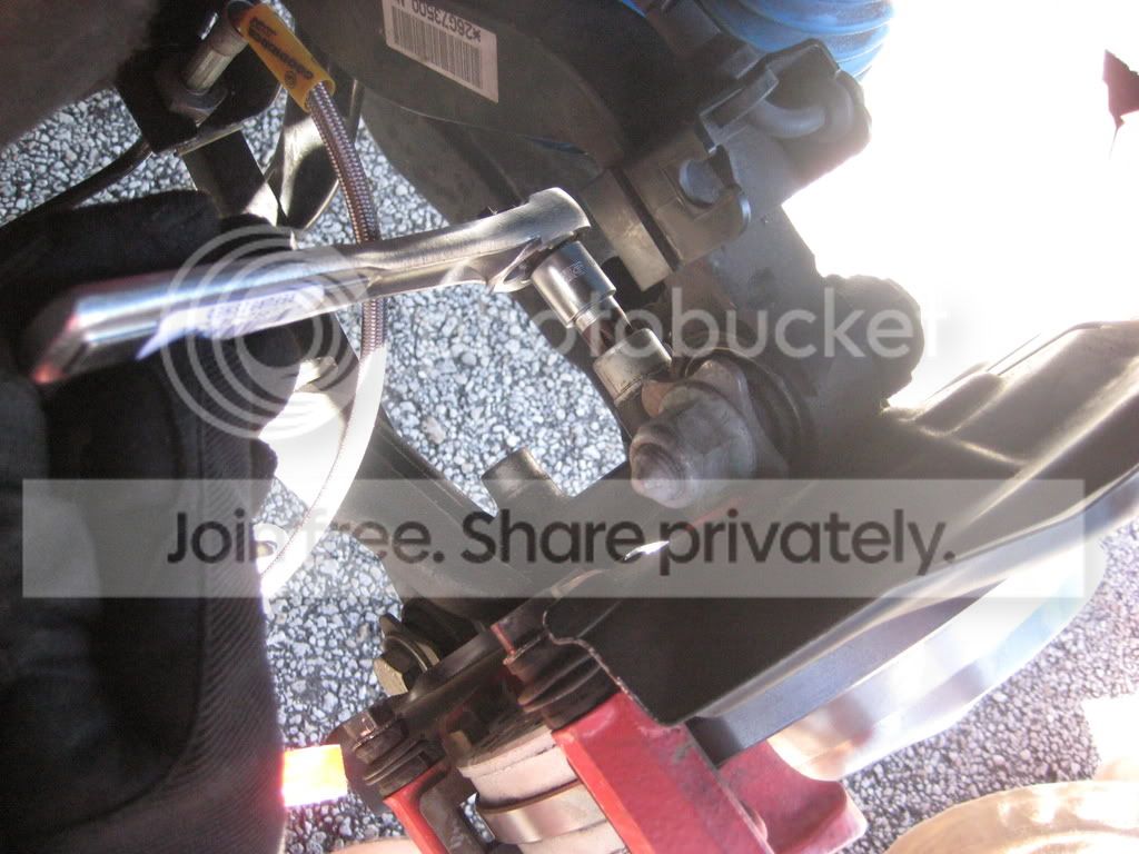

2. Remove the two bolts from back of the caliper using 13 mm and 15 mm wrenches

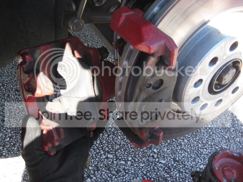

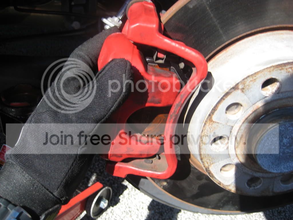

3. Remove the caliper, rest it on a jack or zip-tie it up so that the lines don’t stretch
4. Remove the two bolts holding on the carrier using an M14 twelve point bit.

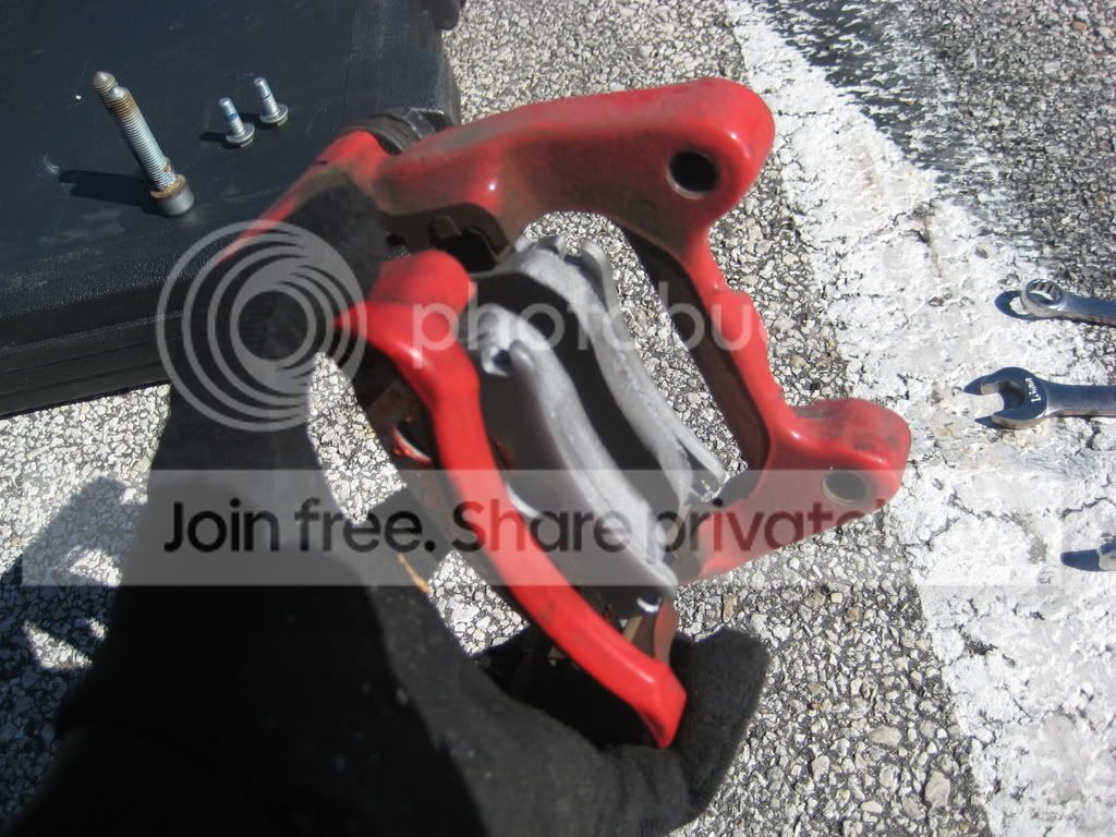

5. Remove the carrier and remove the old pads from it. Set it aside.

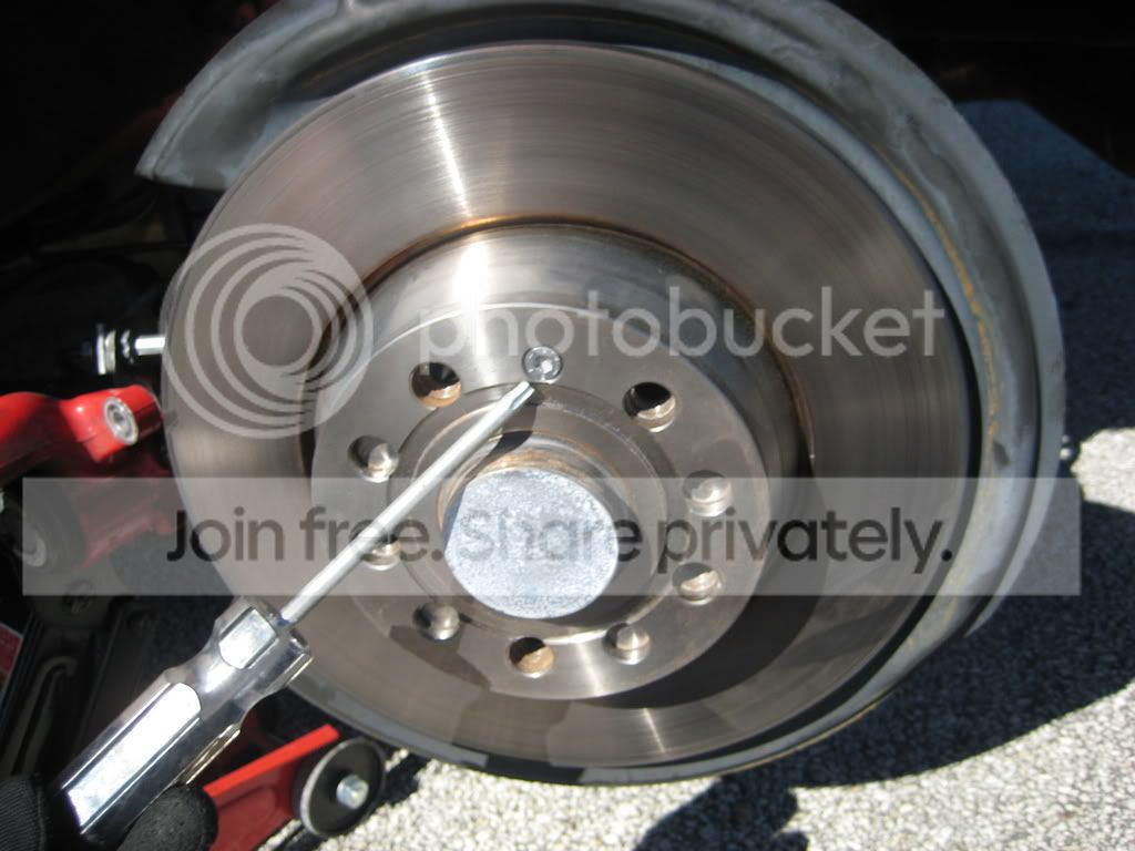

6. Using a T30 bit, remove the screw holding on the rotor and remove the rotor
7. Sparingly apply some anti-squeal paste to the back of the pads, be sure to not let ANY of it touch the surface of the rotors or pads. Spread it with a plastic shopping bag or other clean-disposable spreader
8. Place the pads in the slots in the carrier
9. Replace the rotor and bolt the carrier back on, place some grease on the carrier bolts

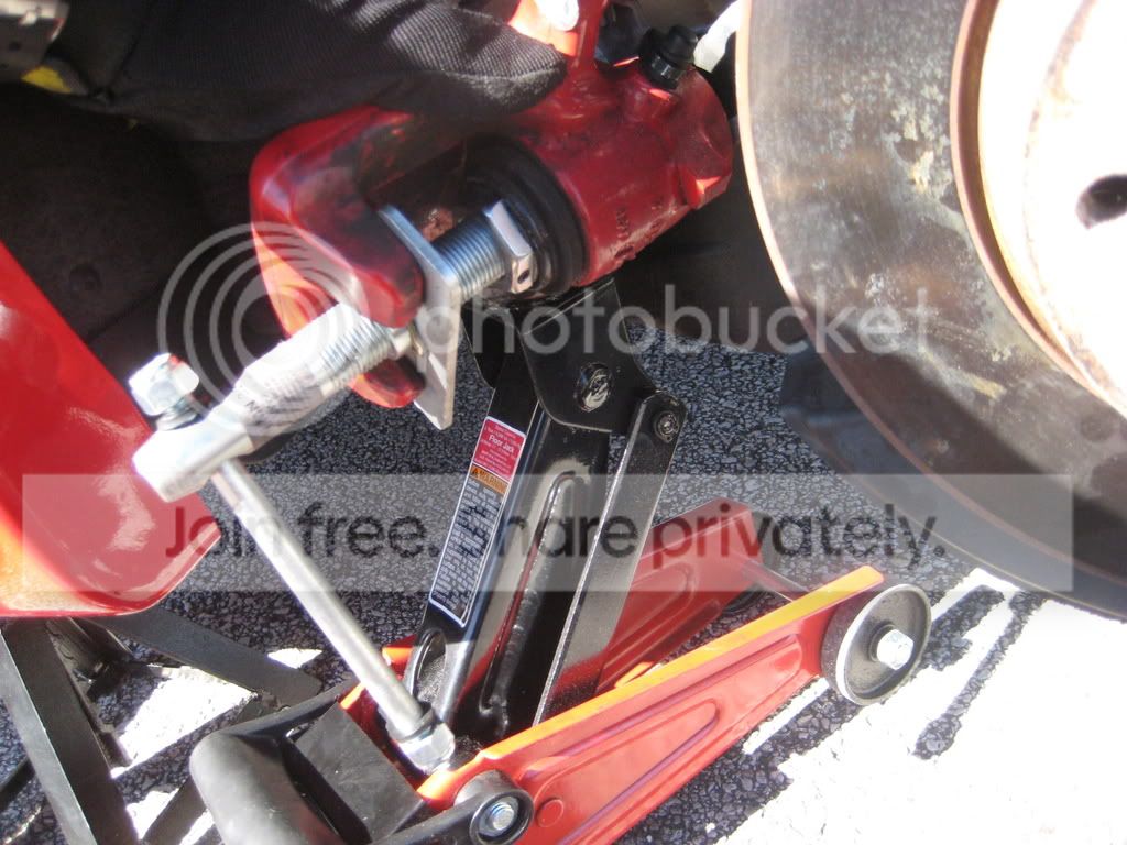

10. Using the piston resetting tool, compress the piston as far as possible
11. Slide the caliper onto the carrier and bolt the caliper back on

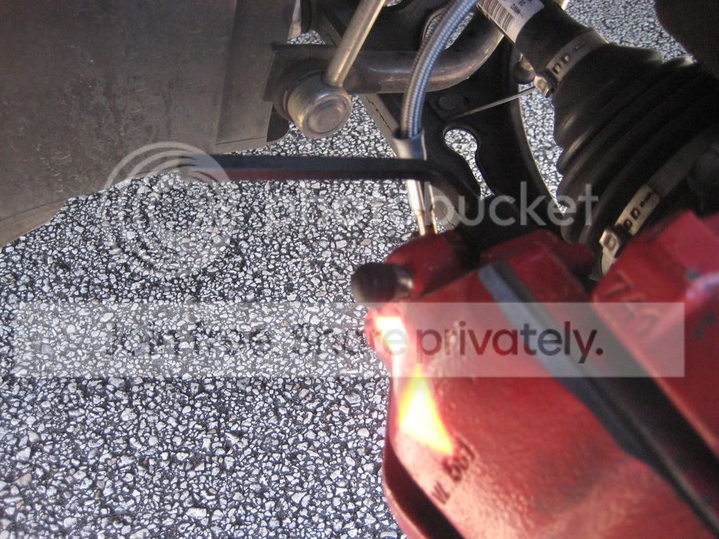

Front Brake Pads and Rotors
****If you are only going to swap pads, skip steps 4-6****

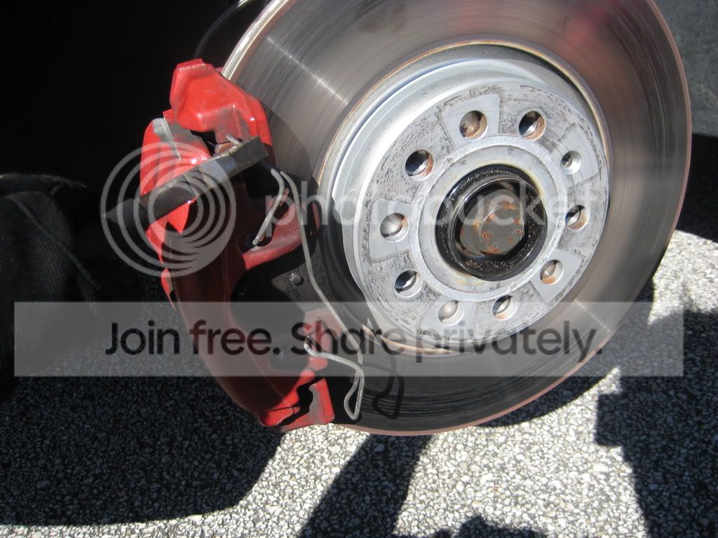

1. Remove the metal clip holding the front caliper to the carrier using a large flathead screwdriver or pliers
2. Remove the black plastic caps covering the bolt that hold the caliper on. Using a 7 mm allen wrench, remove both of the bolts.
3. Remove and secure the caliper so that the lines aren’t stretched

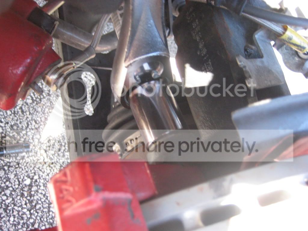

4. Using a 21 mm socket, remove the bolts that hold on the carrier
5. Then remove the carrier and the screw that holds the rotor on, remove the old pad from the carrier
6. Replace the rotor and the screw that holds it on, then lightly grease the carrier bolts and bolt the carrier back on

8. Sparingly apply some anti-squeal paste to the back of the outboard pad, be sure to not let ANY of it touch the surface of the rotors or pads, place the pad in the carrier

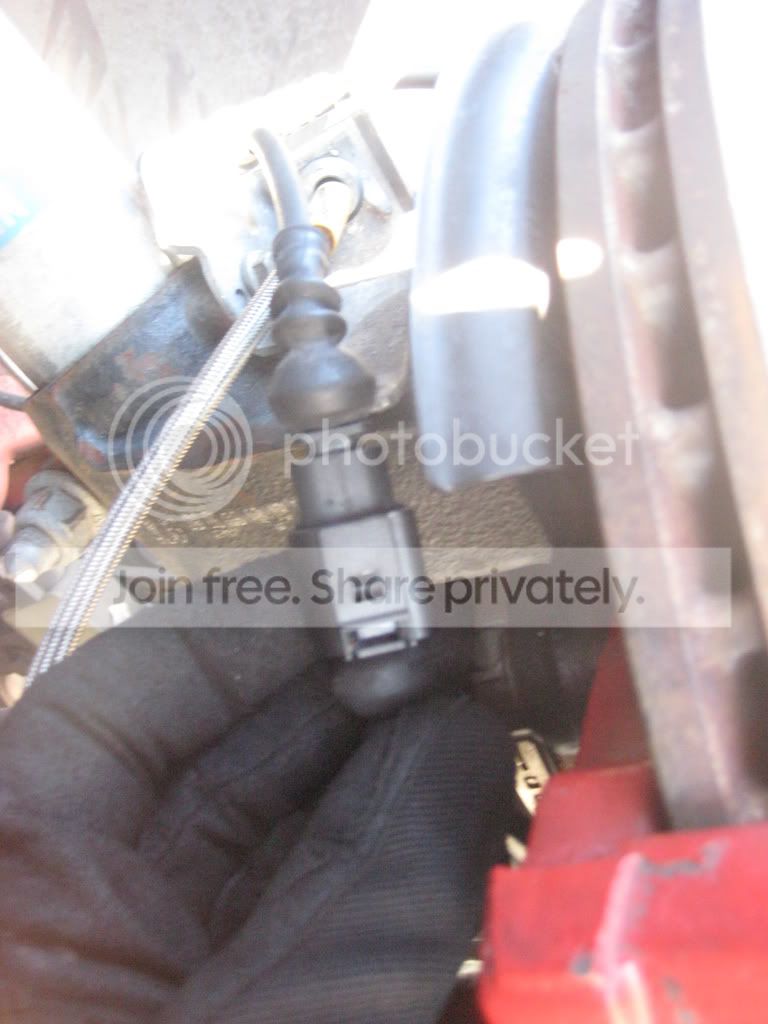

13. Repeat for the other side. NOTE: if your pads come with wear-sensors, you will have to unplug the cable from the old pad and plug it into the cable on the new pad. The pad with the wear sensor is the inboard pad on the front left side.
