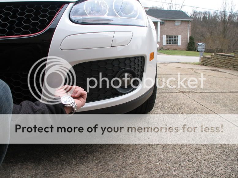

well i'm going to try and help out the text with a little diy..
i couldnt stand the yellow hue of the factor bulbs in the fogs lights so i wanted a good replacement. I decided to go with silverstar light bulbs. the fog like bulbs are 9006's. i had the silver stars in my jetta mk4's headlights and i thought they were great, especially for the price. i got both of them for 45 bucks.
![](/forums/proxy.php?image=http%3A%2F%2Fi38.photobucket.com%2Falbums%2Fe104%2Fsnowhare%2Ffogs%2Fdiyfogs002.jpg&hash=6cb0469049cbe5b11cbfff849090d27d)

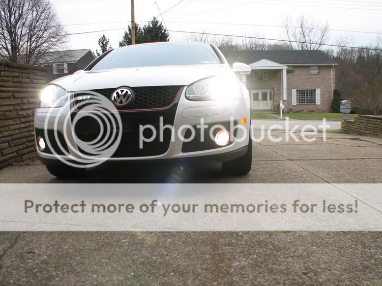

this is the light output of the stock bulbs
![](/forums/proxy.php?image=http%3A%2F%2Fi38.photobucket.com%2Falbums%2Fe104%2Fsnowhare%2Ffogs%2Fdiyfogs001.jpg&hash=dc6104b63331f9cc01e82464f694bd8f)

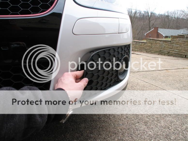

so here we go.
first locate the open honeycomb where there is screw that holds the grill in.
![](/forums/proxy.php?image=http%3A%2F%2Fi38.photobucket.com%2Falbums%2Fe104%2Fsnowhare%2Ffogs%2Fdiyfogs004.jpg&hash=b045669d44823707f7fbb30cd694fbac)

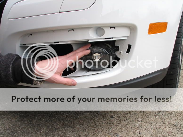

unscrew and pull
![](/forums/proxy.php?image=http%3A%2F%2Fi38.photobucket.com%2Falbums%2Fe104%2Fsnowhare%2Ffogs%2Fdiyfogs005.jpg&hash=39a42cee7aaa0eb6c52799dcc389b5eb)

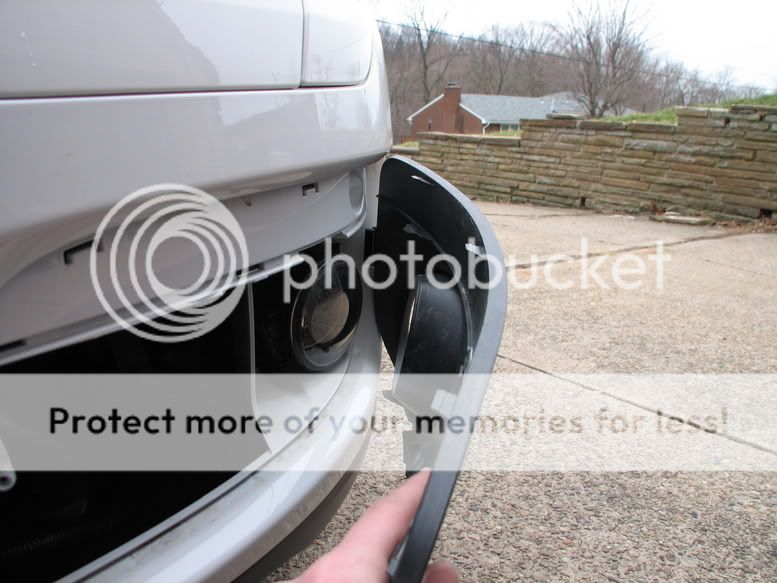

i found it is easiest to pull this way. and back towards myself
![](/forums/proxy.php?image=http%3A%2F%2Fi38.photobucket.com%2Falbums%2Fe104%2Fsnowhare%2Ffogs%2Fdiyfogs006.jpg&hash=f0859e4795137f3e740f51a11381f823)

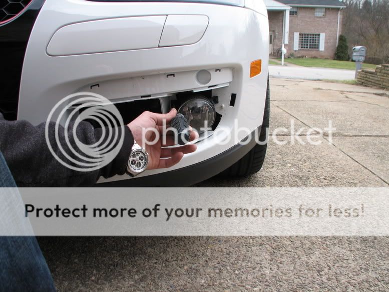

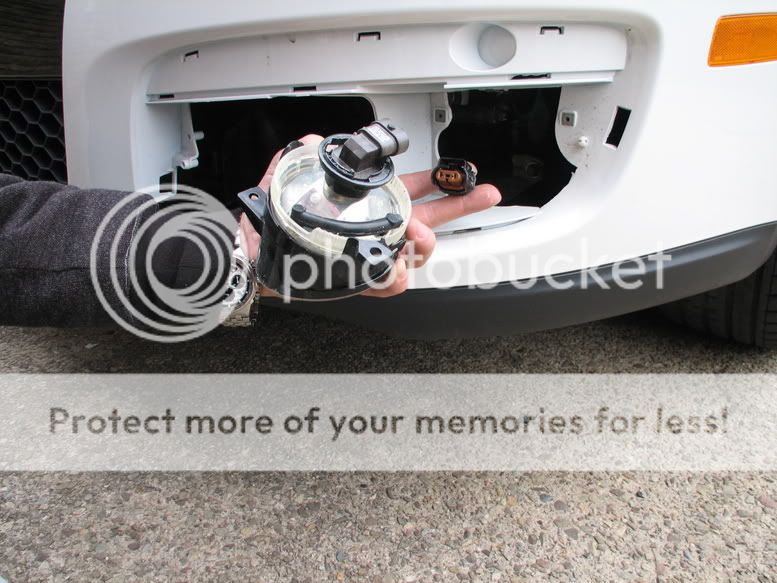

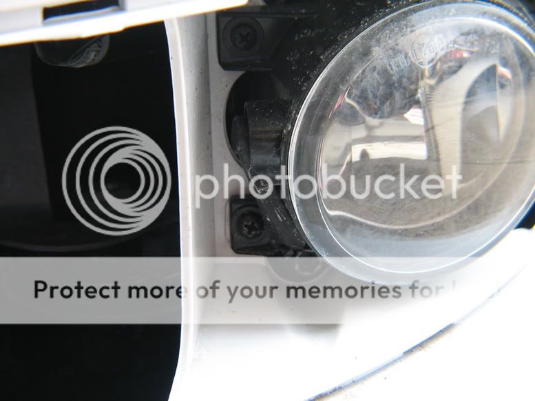

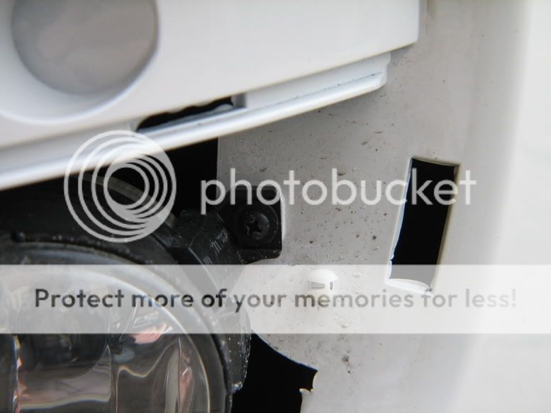

now locate the three screws that hold the housing in place and unscrew
![](/forums/proxy.php?image=http%3A%2F%2Fi38.photobucket.com%2Falbums%2Fe104%2Fsnowhare%2Ffogs%2Fdiyfogs009.jpg&hash=5e04f6fcf4beece3f23f6e0aeea3f5ed)
![](/forums/proxy.php?image=http%3A%2F%2Fi38.photobucket.com%2Falbums%2Fe104%2Fsnowhare%2Ffogs%2Fdiyfogs010.jpg&hash=429dc6c72881036abdbb808f834d1a57)
![](/forums/proxy.php?image=http%3A%2F%2Fi38.photobucket.com%2Falbums%2Fe104%2Fsnowhare%2Ffogs%2Fdiyfogs008.jpg&hash=7d37512279cf21d0852dc4394739cb3c)

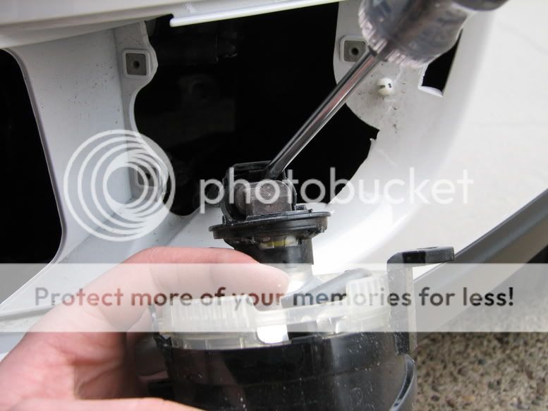

now that the housing is free place ur screw driving lightly into harness to unsnap
![](/forums/proxy.php?image=http%3A%2F%2Fi38.photobucket.com%2Falbums%2Fe104%2Fsnowhare%2Ffogs%2Fdiyfogs012.jpg&hash=c1347abc89eb3a31729b884df160106c)

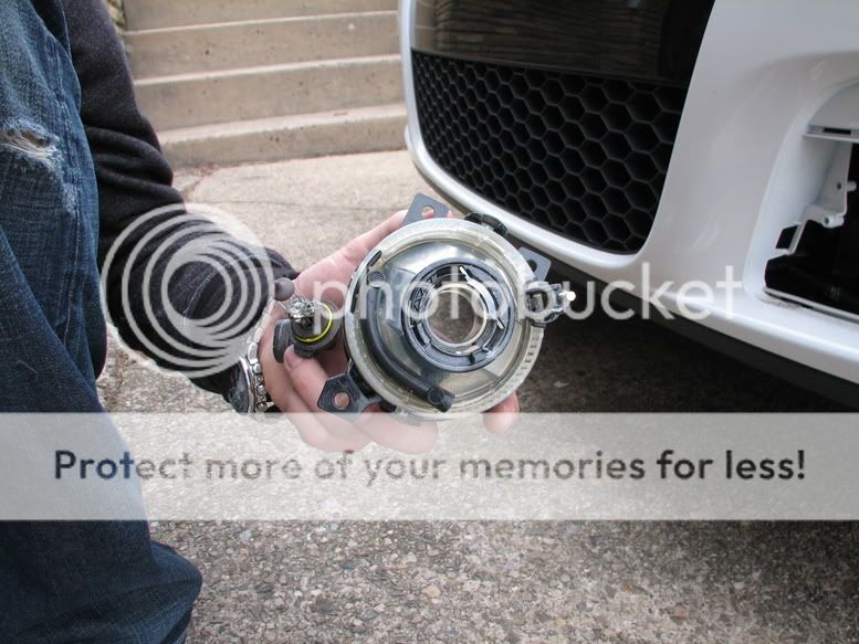

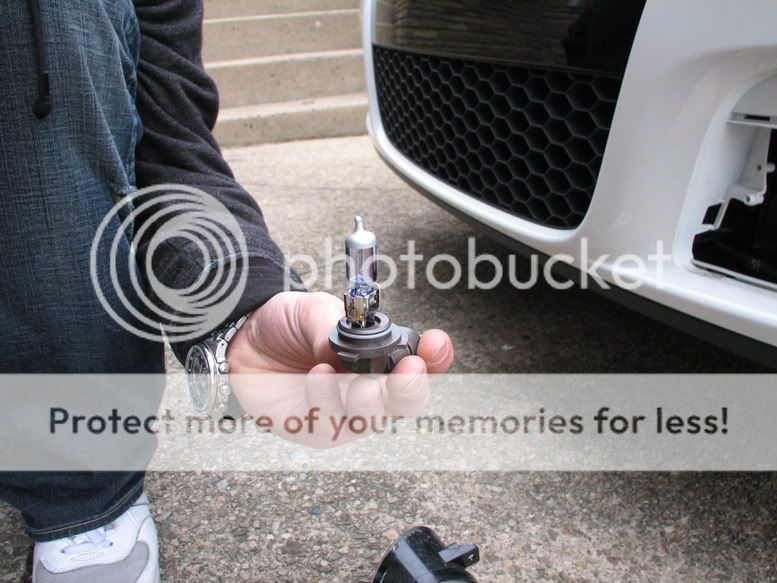

twist blub out and here is what u will have
![](/forums/proxy.php?image=http%3A%2F%2Fi38.photobucket.com%2Falbums%2Fe104%2Fsnowhare%2Ffogs%2Fdiyfogs015.jpg&hash=a6a9ad14ba8d2b763f58b5740832ed07)
get new blub and put in place
![](/forums/proxy.php?image=http%3A%2F%2Fi38.photobucket.com%2Falbums%2Fe104%2Fsnowhare%2Ffogs%2Fdiyfogs016.jpg&hash=3db913683725af36841614f19f165c5e)

i choose to place all 3 screws in lightly, hold in place that i wanted the housing and tighten. **make sure u dont tighten to much, it can cause damage**
![](/forums/proxy.php?image=http%3A%2F%2Fi38.photobucket.com%2Falbums%2Fe104%2Fsnowhare%2Ffogs%2Fdiyfogs018.jpg&hash=a0bb77b923bd067dfaadf3a5d76f02c4)

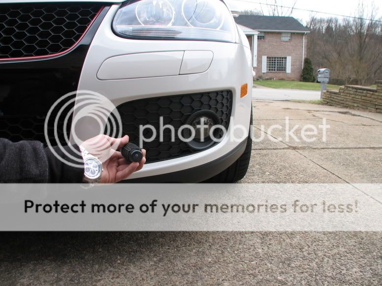

to replace grill start it like this
![](/forums/proxy.php?image=http%3A%2F%2Fi38.photobucket.com%2Falbums%2Fe104%2Fsnowhare%2Ffogs%2Fdiyfogs021.jpg&hash=3c31c7ec7c9a73135bcbd31941db318f)

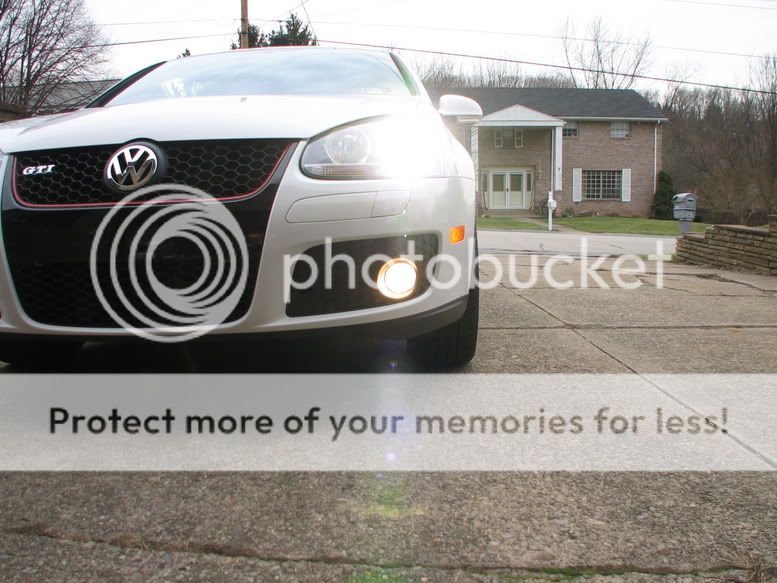

the new light output..sorry i dont have any at night yet.
![](/forums/proxy.php?image=http%3A%2F%2Fi38.photobucket.com%2Falbums%2Fe104%2Fsnowhare%2Ffogs%2Fdiyfogs022.jpg&hash=1663e3b9a60008806667e5a63bab6fe1)
![](/forums/proxy.php?image=http%3A%2F%2Fi38.photobucket.com%2Falbums%2Fe104%2Fsnowhare%2Ffogs%2Fdiyfogs023.jpg&hash=229ed205602c75600bb162c21f90a40f)
