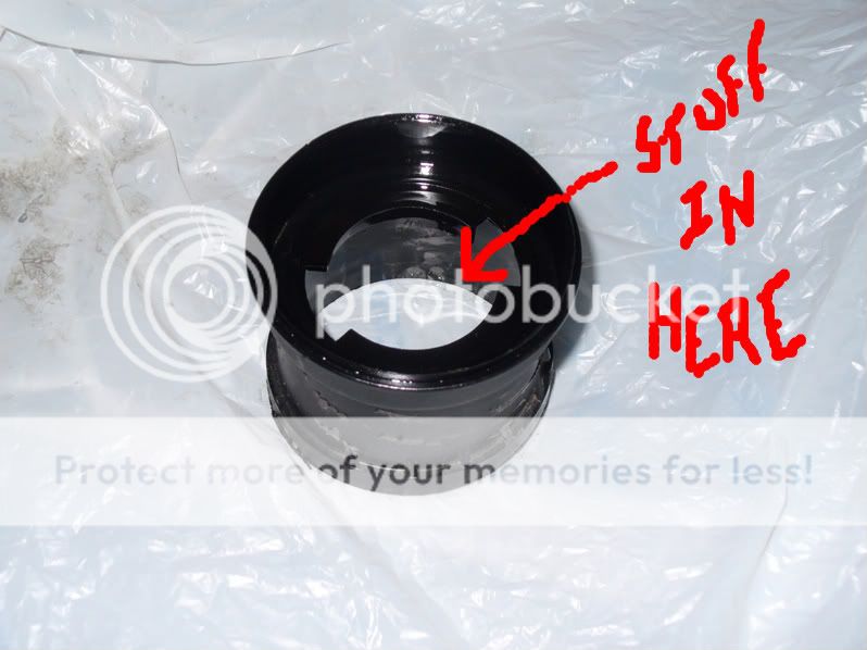

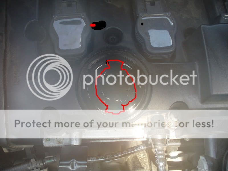

1) First remove the oil cap and look at the bottom to make sure at the bottom there are notches for the cap to plug in down there (I'm not sure if all 2.0t's have these at the bottom. Please ensure before you move on. If your not sure take a picture of down in there and send it to me and I'll look to see if they are there). The notches should be at the bottom and look something like this. (red outline) PS I also have no idea if the new TSI or TFSI have these attempt at your own risk!!

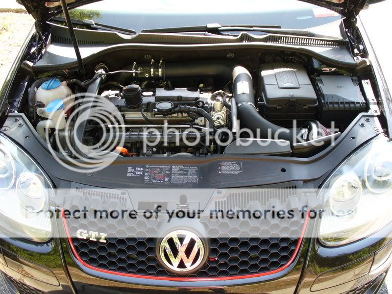

Before:

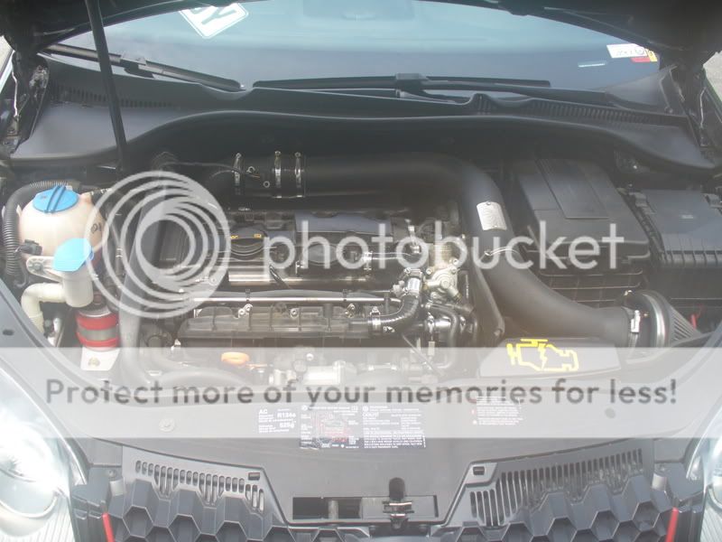

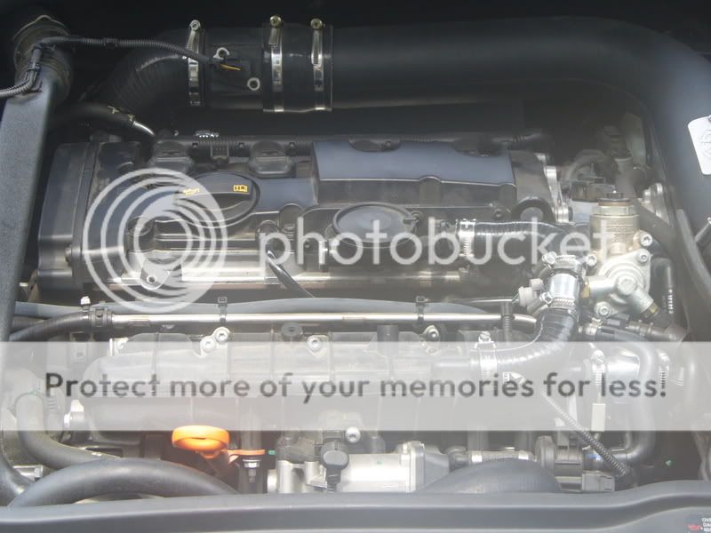

After:
Thanks to Cakeprez for the info. I personally feel this makes the engine bay look alot more "stock looking" after a filter on a stick is installed.
