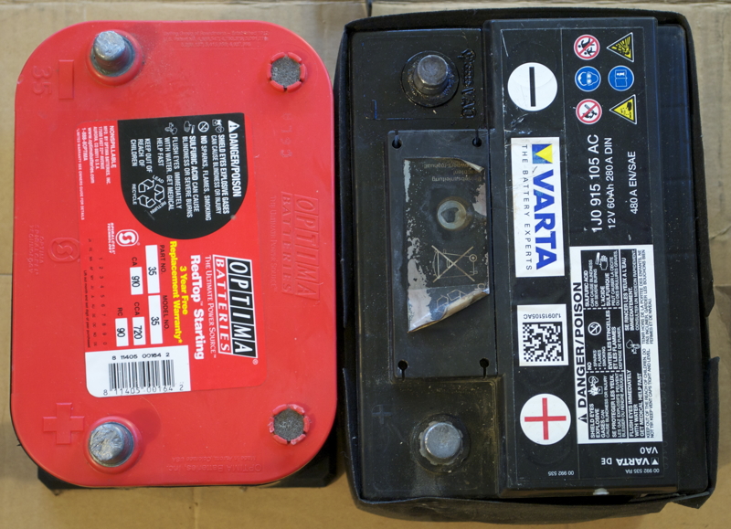

For replacement, I am now debating between an Optima Red 35 or a Deka 70 - 9AGM48 - AGM Battery.

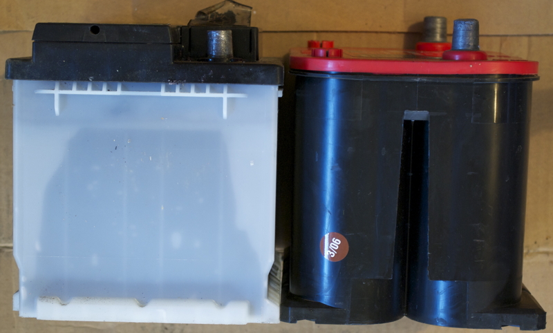

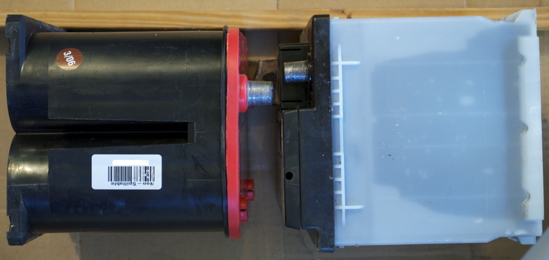

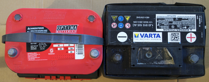

I have a dead Optima 35 on hand, so I was able to test fit the Opitma 35.
It is slightly smaller than the stock battery - shorter and narrower, and
although the posts are tiny bit taller than the stock battery,
they still clear the box cover.
The base mates with the hold down clamp just fine.
The position of plus and minus is correct,
the posts are near the right place and the cables connect easily.
The oe blanket fits (loosely) and the stock box cover closes normally.
i.e. Optima Red 35 fits without modification.
Battery size comparsion - oe Varta <-> Optima Red 35
piece of wood used to line up the mounting cleat at the bottom to accurately compare the post position when mounted
installed comparison

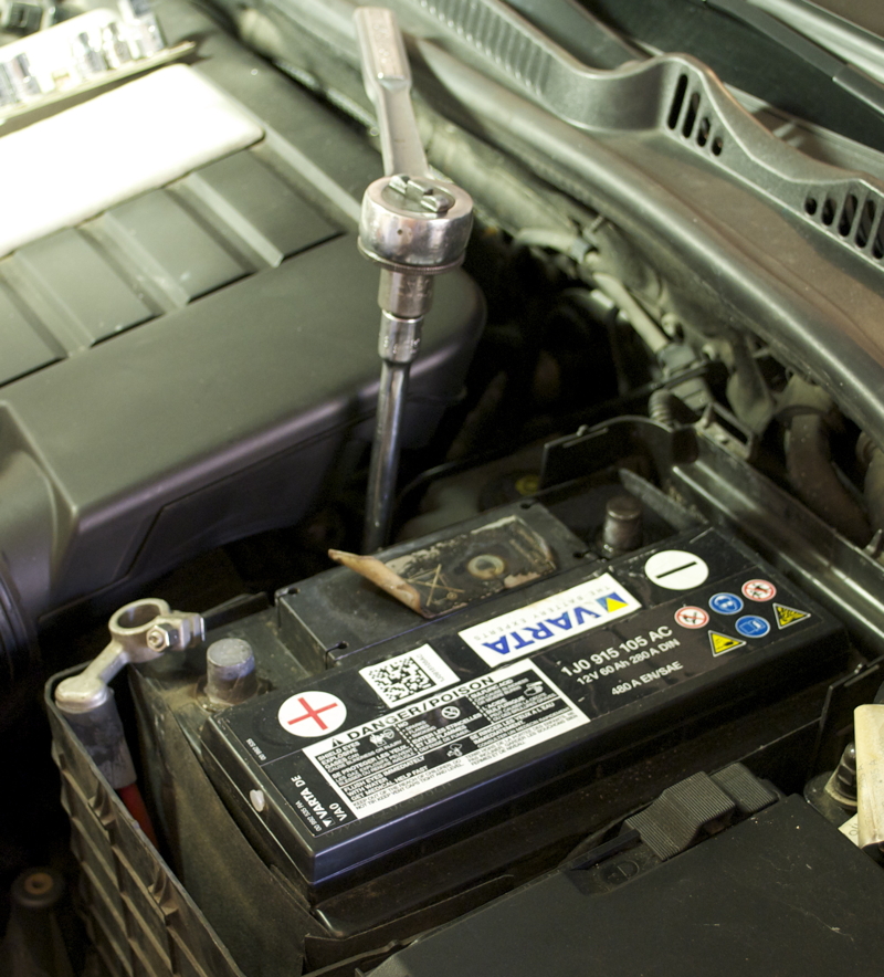

Battery removal DIY ...
Loosen the 10mm bolt on the battery connections, remove terminals from battery posts

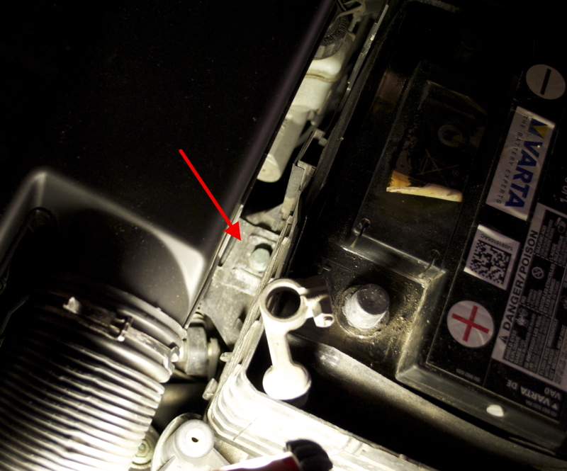

Locate the hold down 13mm bolt and hold down clamp on the bottom side of the battery, outside the battery box
Use an extension and ratchet to remove hold down bolt and clamp

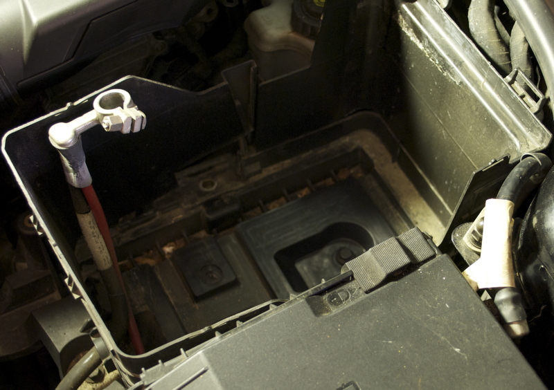

hold down bolt and clamp removed

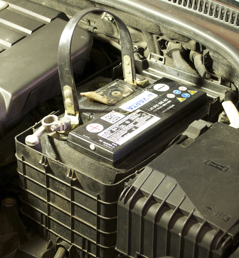

Remove battery - I used a battery strap to pull the battery (w/blanket) free

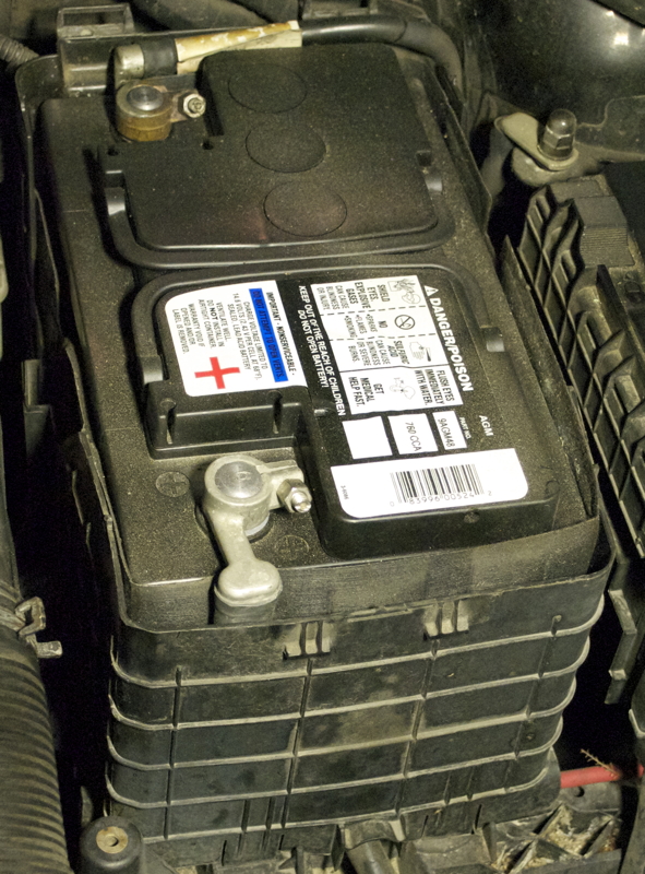

Anyone have any installed or comparison pictures of the Deka AGM battery?
Any experienced comments?
The Deka battery is a little longer than the OEM battery. It still fits, but you can't tuck the fabric insulator tab in the way you can on a smaller battery. You can still use it. It just doesn't overlap itself anymore. Everything else fits fine. Two years and no problems.

the battery hold down bolt, isnt that just to hold down the plastic battery box itself?
is the actual battery secured? or is it more a matter of it is in the box so it shouldnt move
JetTurbo
geezer
South Florida, USA
2018 GTi Autobahn 6M
No
...is the actual battery secured?
Yes, absolutely.
... or is it more a matter of it is in the box so it shouldnt move
No, it is not. You can remove the plastic box sides completely and it will still not move.
The plastic box sides are attached to the same box base that the battery clamps onto.
It is more the other way around,
the battery is a solid structure and the box is flexible,
the upper box gains strength from the rigidity of the battery inside it.

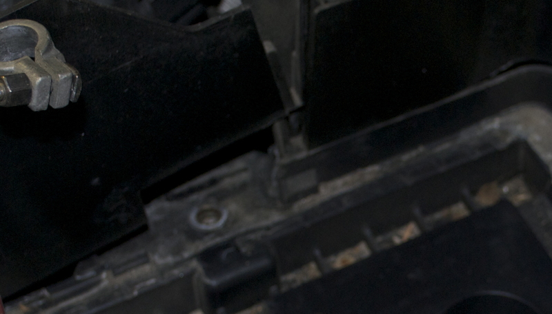

The clamp under the bolt holds the base of the battery to the base of the battery box.
The base of the battery box is never unbolted.
The opposite edge of the battery is wedged under hold down parts in the box base too.
The metal plate / clamp provides a bit of adjustment for minor size variations.

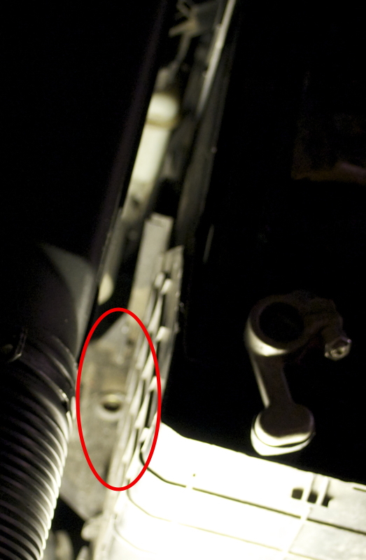

I do not have a good picture at the moment of the
slot cut in the base of the box on the hold down side.
The slot allows the battery to be bolted down independent of the outside cover.

update
update: Deka 70 - 9AGM48 - AGM Battery purchased from Remy Dec 2010 - 2 yrs & 70k mi - still going strong :wink:
BTW the battery I bought has been superseded.
Link in post #1 Deka / Remy part # 9AGM48 link takes you to its
replacement, Deka Intimidator 9A48 High Performance AGM Battery
Deka / Remy part # 9AGM48 installed Dec 2010
