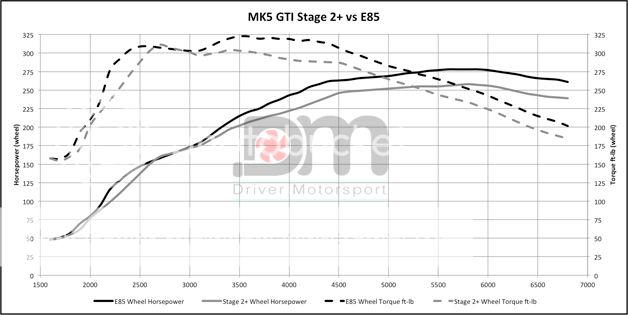

We do Stage 1,2,2+ tunes, Dyno Graph shown here:
Stage 2+ E85 tunes, Dyno Graph shown here:

Looking at your crank & wheel HP numbers for the K04 file. OP talked about a higher output K04 file. DO you have any numbers on that Driver Motorsport?
DriverMotorsport
Tampa, FL
That would be similar to the Golf R file power output. The high output file would require a Golf R map sensor to be ran because boost pressure will exceed 2550 mbar of absolute pressure.
The advantages of this file is an increase in midrange torque. Unfortunately, I have not dyno'd this file yet.

Op said new tune what were you running before? Or are you just saying you went with a newer companies ko4 tune vs an older one? Did you switch map sensors? Seems power output is right about same as the file i run in pump mode. Would love to see dyno and look at the plot.

Also interested in the golf R map sensor upgrade and how this affects power on a k04 tune.
As it stands? The power output is good but not mind blowing compared to other tuners.
DriverMotorsport
Tampa, FL
The power output shown is with boost pressure within the map sensor limit of 2550 mbar of absolute pressure. With ~22 PSI out of a K04, that's really the best you can get.
The Golf R map sensor means the tuner can see what boost pressure is doing over 2550 mbar. Means in the midrange, there is much more power available.
Expect an increase of 10whp/10wtrq after installing the map sensor. For such a cheap and simple item to install, 10whp/10wtrq is a good pick up.
