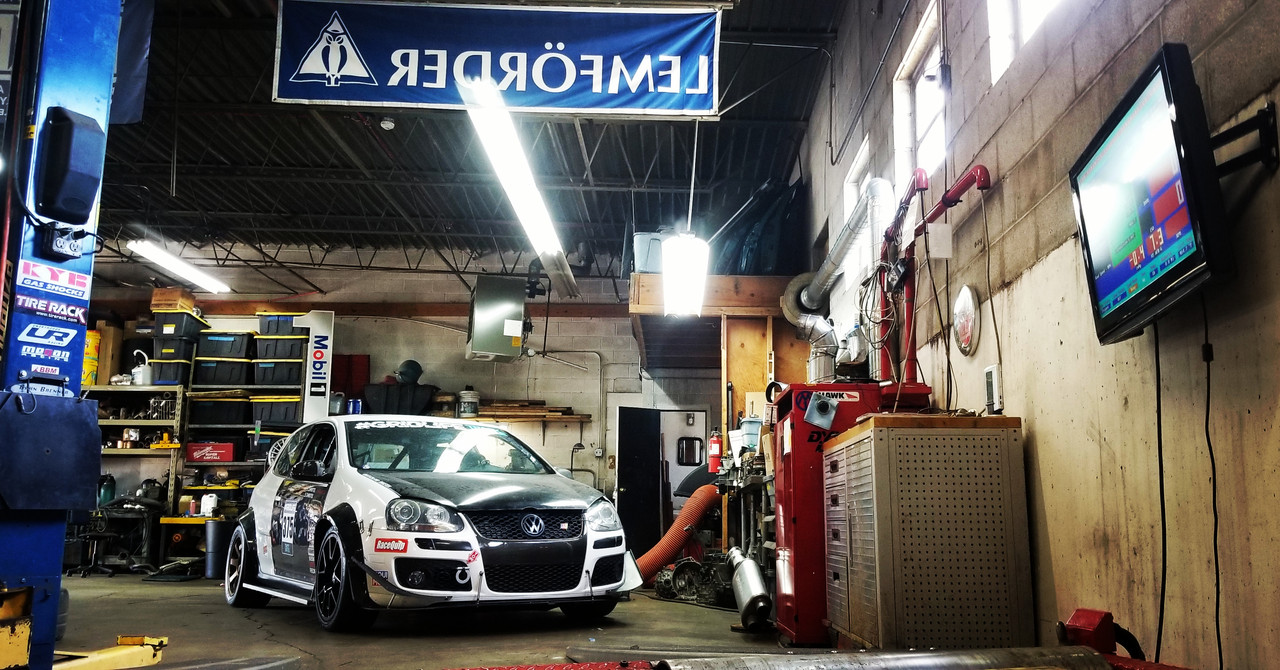

Project racecar. Build #1
**Edit**
Figured I'd keep an updated picture at the beginning.
**End edit**
Soooo, a little back story. 1 month before Christmas thought my turbo blew, so as my moto goes, upgrade as it breaks ( the car tells me what my next mod is lol). So I continued my research on turbo upgrades with a renewed vigger.
And bought this for when the GTI is down.
It turns out my CC send line froze and took out my valve cover gasket.
So a $18 repair later the GTI is up and running. However, my turbo is on its last legs and its about time to give the old girl an over haul. Now enter my end decision. Decided Frankenturbo has their shit together and DM has been doing some awesome things as well as being an awesome contributor to this forum. Mad respect to both companies for showing how a tuning/hardware company should be!!!
This is going to be a slow build and pieced together over the next 2 months, but end results should be satisfying

You can see in my sig what I already have done, so now the supporting hardware starts going on. First up is the APR hpfp, found a killer deal and a good guy on in the classifieds and pulled the trigger. Doing a swap from Illinois to California (thank god I have the truck lol). Waiting for the new pump to come in, the long 8 day wait begins.
As she sits now, waiting for the pump
Was time to do the follower anyway lol.
Good by pump, you have done well and served your owner very well!! (stage 2 not one fuel cut)
I will keep this updated as I move along, SPM intercooler comes in 2 weeks!! DM Stage 2+ shortly after. So stoked! If anyone out there has some words of wisdom ( I'm looking at you Bunnspeed, Eurocars, RedSpade, Freshpots, Brokenparts, Vegas, you know who you are)
Like I said, will be slow due to my money tree only growing lemons, seriously if I had as much money as lemonade.... uhhhh.

It should be noted, I originally did not plan on turning this into a full fledged race car, but things have a funny way of working out. Not sure at what point I just went full retard and said screw it, but I did and there's no going back now. When you are this far down the "rabbit" hole it just makes more sense to keep digging.
