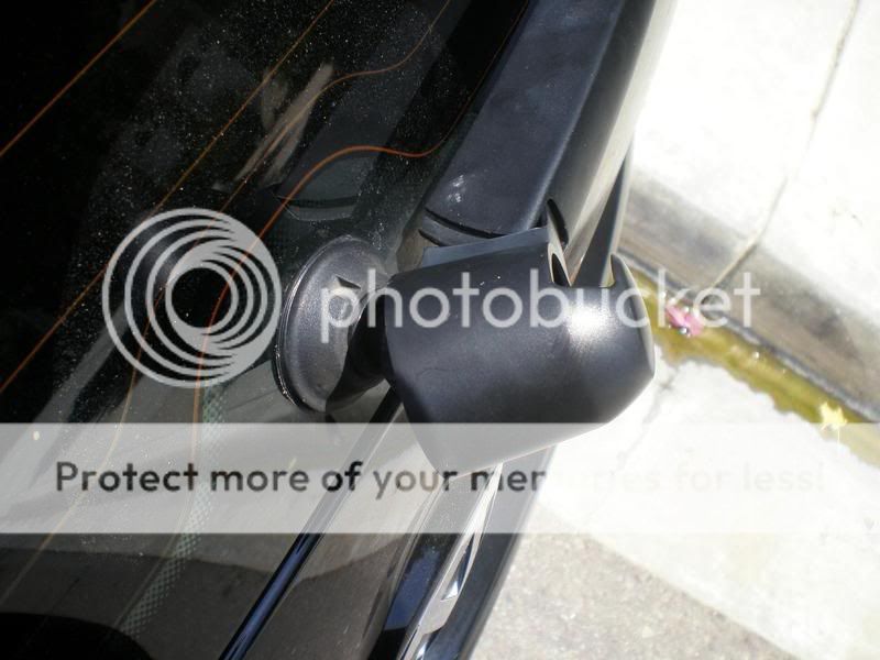

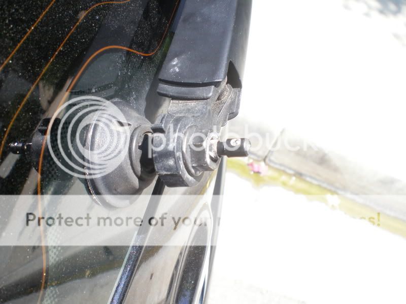

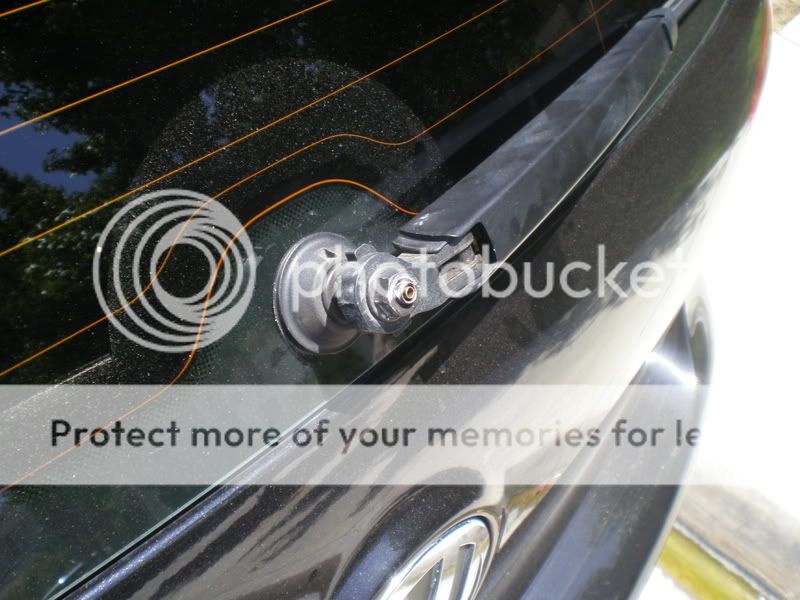

this is a easy DIY nikytynick shows how to take off and i am saying how to keep the cover so it wont look ugly
YANK
REMOVE
PEE!

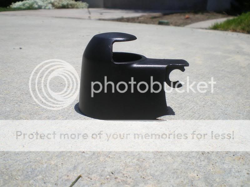

heres a good look at the cover, you need to pull it from the hinge on the side to get it to come out

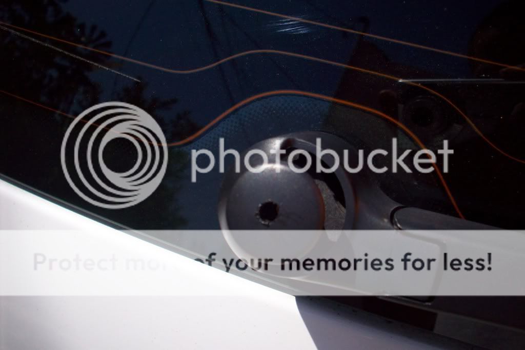

Here is my pee hole on my rabbit i got a torx and a lighter hold the torx over the flame for a few seconds then push through the cover and presto!!!!you can always put the washer back when you car gets dirty but i think sucks to wash your windows with the washer cuz all the water goes down and then gets the car even more dirty so ill leave my washer off lol

Putting the pic of the cover is a good idea, got any pics of the inside of the cover, just so we know what we're working with?
