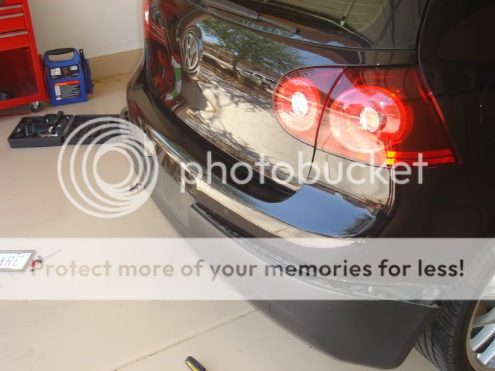

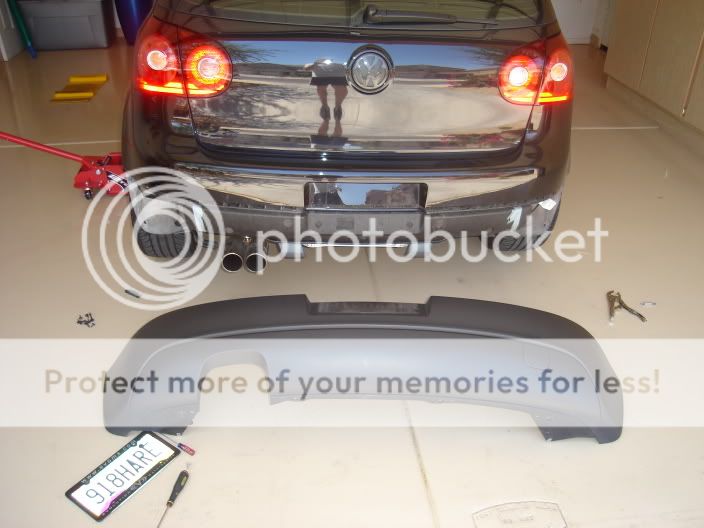

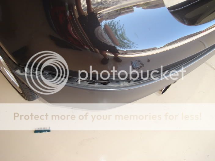

Here is pics of some of the rear, please keep in mind that I suck with pictures and I did not decide to take the pics until I was done so it is not exactly a perfect step by step

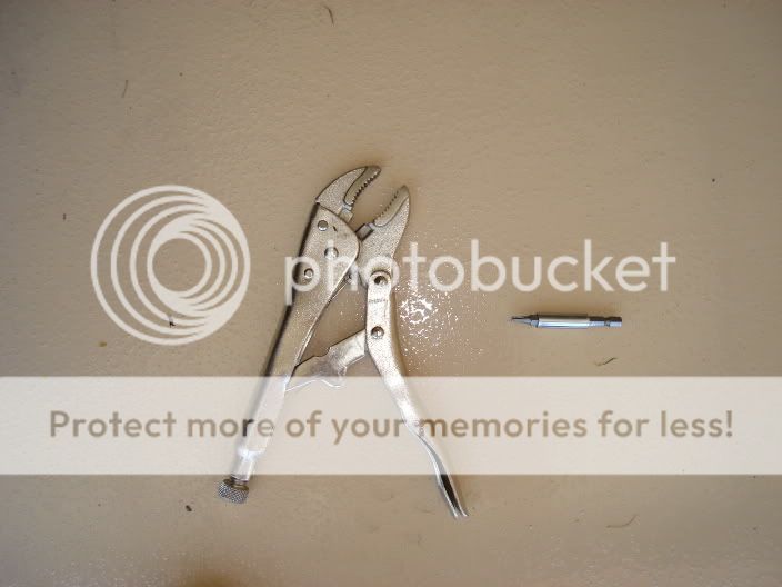

First I had to jack the car up one side at a time to get to the screws inside of the rear fender wells. You probably do not need to do this if you are not too low or have put on biger wheels and tires.
Tools used:

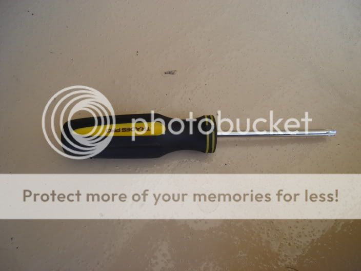

Torx 15 screw driver
Torx 15 bit and wrench to get into fender wells so I did not need to remove the wheels
Remove the license plate

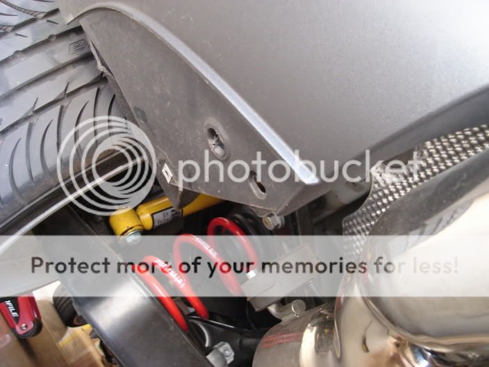

next remove the 2 torx 15 screws from inside to the fender wells. I had to di this one side at a time, with the car jacked up and using the modified (half ass) tool.

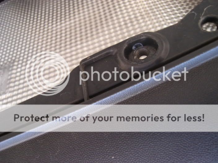

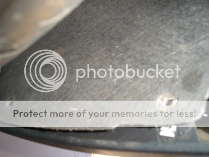

with all four side screws removed, climb underneath the car, you will see approx. 4 more torx head screws, starting at the corner remove these screws
corner
middle
once all of the screws are out slowly remove one side, just to where the bumper curves around
then the other side
slowly work both sides off and all done
took me probably 15-20 minutes max
