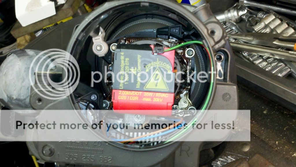

Once you have the lights out pop the back main access cover off and you will see the headlight internals.
You need to remove the ignitor, just give it a twist and it will pop free. The power wire will pop out on its own. Now gently disconnect the three wire solenoid power lead. You can also remove the bulb and locking ring at this time.
There are t-25 4 torx screws that mount the projector assembly to the headlight. 3 are easy to reach, the 4th is directly in front of the auto leveling motor. This is where you need that thin shaft torx bit tool to get that one out. I used the t-20 bit since the larger sixe kept popping out.

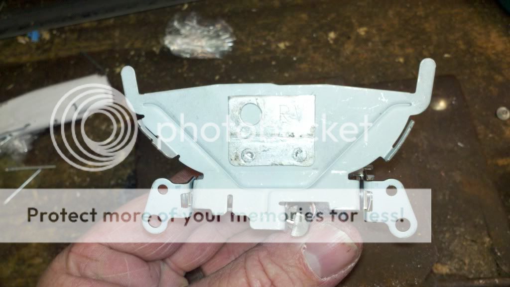

On to the shield.
You don't have to mess with this part if you don't want to. If not skip to the reassembly. I would recommend you test the lights with the RV shield intact first to see if you are happy with it. If you do want to make an adjustment here you have a couple options. You can either grind the rivets out and remove the RV shield to flaten it out and rivet it back to the shield like this. I bent my driver shield in the process so be very careful cause it will give you a funky cutoff.
Or you can use the dremmel and cut off wheel and trim a 1/4" section off of the top and not mess with the rivets. This is what I ended up doing. (pic soon to come) I wouldnt reccomend bending the RV shield down like others have since the shield can bend too.
