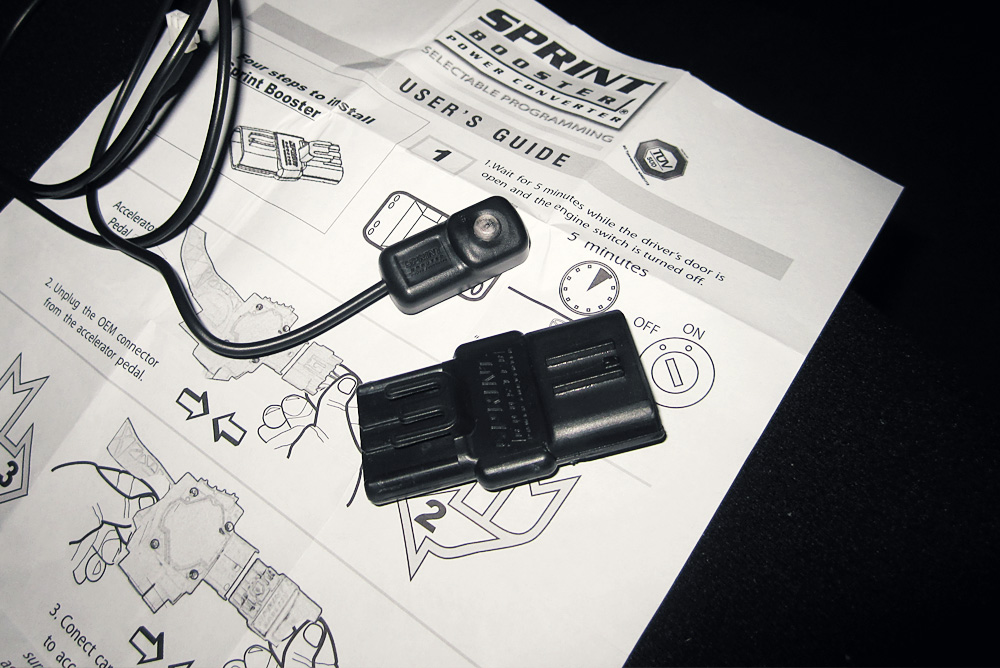

Sprint Booster.

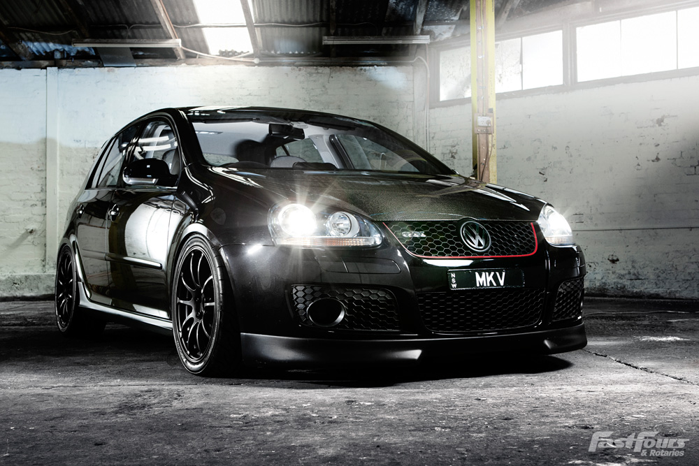

Images from a feature in the January 2012 issue of Fast Fours & Rotaries Magazine. Photography by Chris Sorgsepp. Visit: https://www.facebook.com/FastFoursMagazine

Exterior
- Rieger front lip
- VW front emblem (custom painted gloss black)
- Stubby antenna
- Fog Lights Open Grille
- Fog light delete
- Rear wiper delete
- OEM GTI Grill (euro plate holder delete)
- OEM R32 tail lights
- Rolled guards (top one auto)

- Sprint Booster
