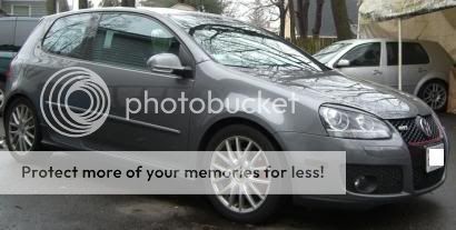

Excellent write-up and pics! I just removed my OE UG mirror covers and signals and replaced them with a set of the R-line textured mirror covers and in.Pro smoked signals!
Before:
After:
Cheers,
Mike B.
