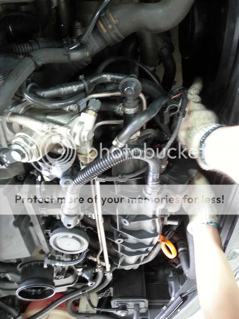

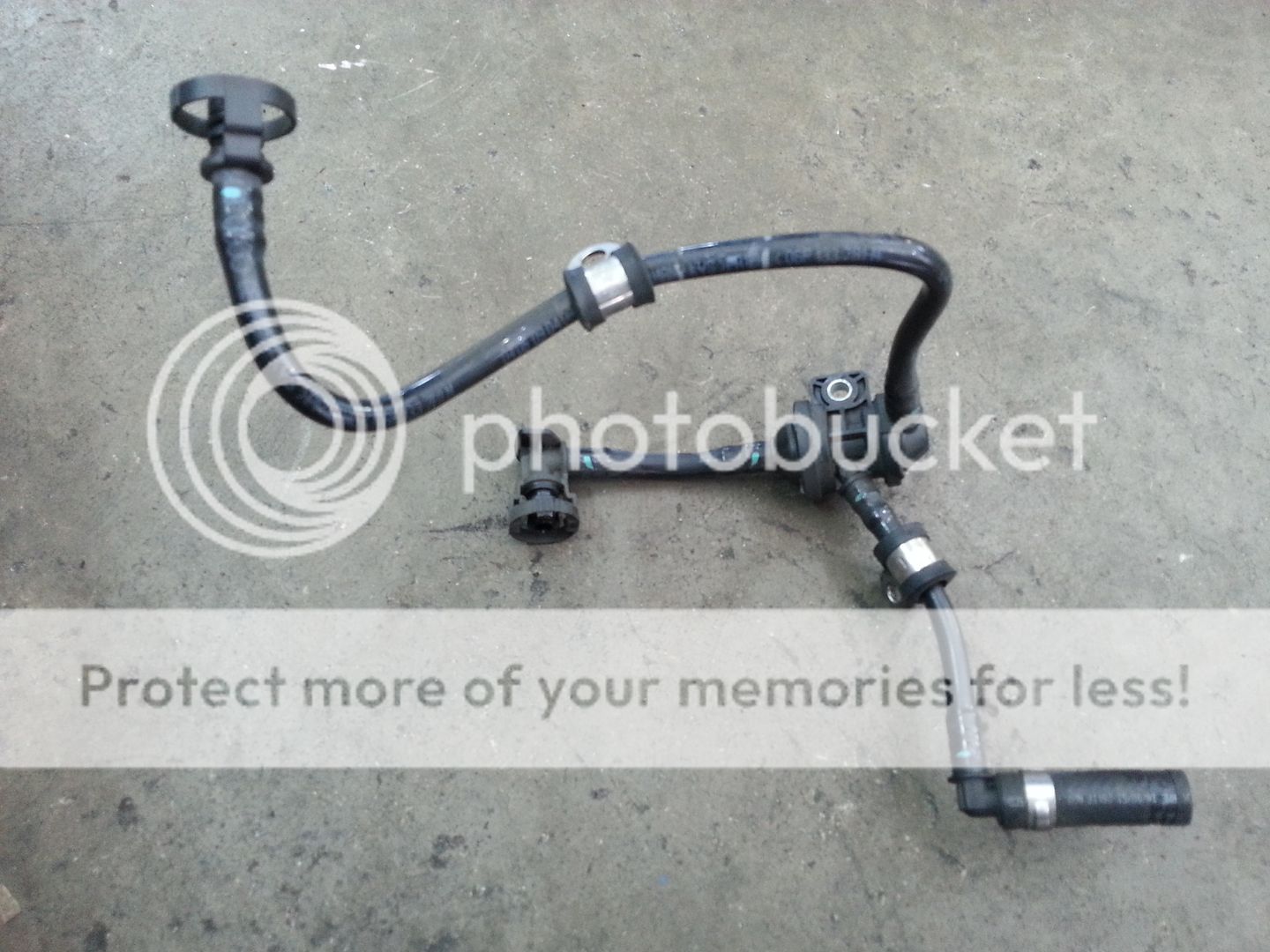

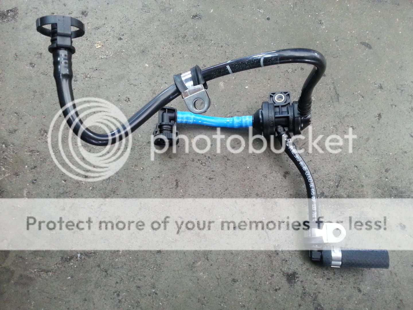

Today, I replaced the carnister purge valve N80, new hose, the Pressure Limiting Double Check valve....the code cleared and did not seem to return anymore.
Getting to the Double Check valve was a real pain ! The mechanic had to remove the throttle housing just to release a retaining screw of the assembly.

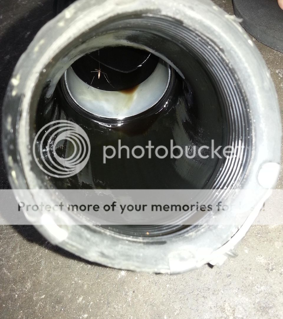

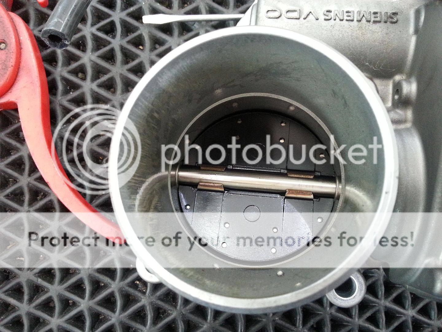

Noticed that there are so much oil everywhere inside the connecting pipes and throttle....I suspect that the purge valve and double check valve failure may have been due to the excessive amount of oil in the intake system.....looks like the Oil Catch Tank may be necessary nevertheless.
The old Double Check Valve Assembly..
The new Double Check Valve Assembly
Oily throttle body
Oil soaked connecting pipe to throttle body
