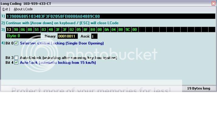

Vag-Com release 704.1 or older
A friend to help hold the hatch.
First.. The VAG-Com work. YOU CAN NOT USE THE LATEST UPDATE, so if you have updated your vag-com to VCDS 8.50, you will need need to re-install the older version 704.1 which can be found here: http://isohunt.com/torrent_details/26816746/vag+com?tab=summary
You need to change the following (at your own risk):
46 - Central Convenience
Byte 2 Bit 3.
Once the adjustments are made and you update the central convenience, you should be able to hit the hatch button on the Key FOB and hear it pop. Without any help, the hatch merely pops, but doesn't get past the release. Until you install the spring, you will need to hold the bottom and lift up on the windshield wiper to get the hatch open. When you open the hatch, you will find that it only needs to go about a foot before the struts can lift it. This is where the spring comes in.

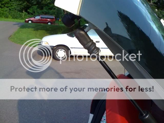

Once you have the spring, you need to:
1. Take off strut from hatch by unclipping the metal clips with a small flat head screw driver. **Once the strut is removed, the hatch will no longer be supported it, so it is best to brace it or have a friend hold the hatch while you are pulling the end off.
2. Unscrew small end of strut with two pairs of pliers
3. Slide on the spring (washers are optional)
4. Put the strut back together and attach it to the hatch.
5. You will notice that the spring will slide up and down as you open it. You can wrap it with 3/4" Heat Shrink Tubing or Friction Tape as someone suggested to keep the spring in place
6. blackgti06 offered a different idea to Number 5. If you don't have shrink tubing or friction tape you can actually pull the end cap of the strut off and slide the spring underneath and replace the cap for an OEM look.
*You can use one spring but most people have been installing 2. For $2.00 a piece, might as well beef it up.
Here is what Buttero's car looks like after the heat shrink.
More pics to come.

Ducky, nice write up. Just a thought that might be mentioned. Not all have had success with the vag part and some codes work on one car but not another, right?
Ducky 2.0T
N/A
Should be mentioned although others have played around with it again and been able to get it to work. So far I have seen it on 2006-2008 GTI's, a R32, a 2007 4-door rabbit and a 2-door rabbit... For the few people that haven't gotten it to work, I am willing to bet they set something wrong.
