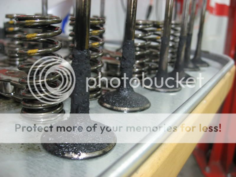

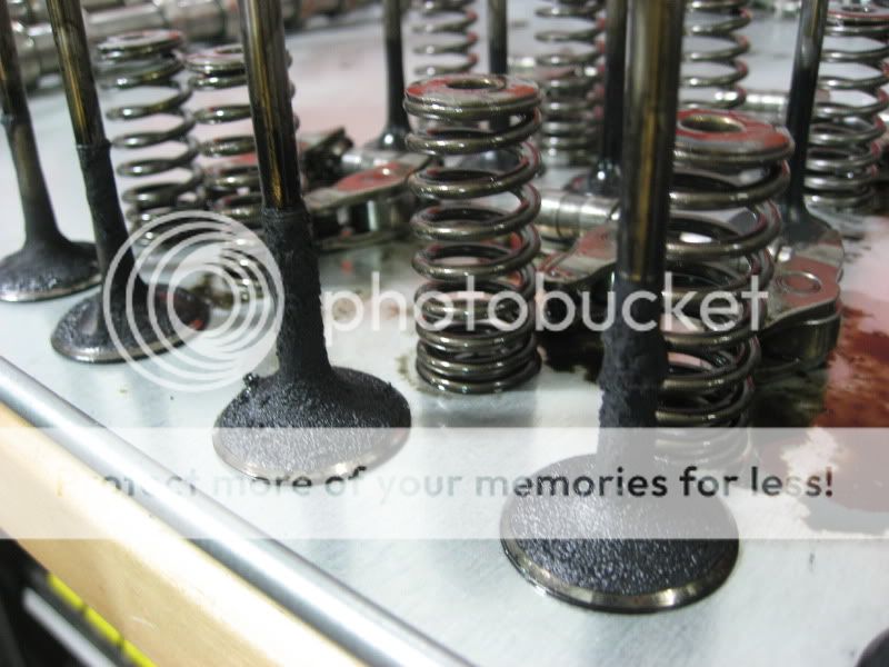

FSI CARBON BUILD UP from a vehicle with under 60k and Upgraded Turbo System, this cylinder head showed "Mild" Build up compared to other vehicles we have serviced
Un-Cleaned Valves Removed from Cylinder Head

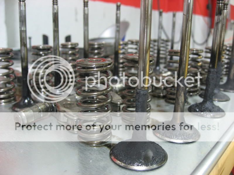

Sea Foam Cleaning on Two Valves while they were still in the Cylinder Head VS. Un-cleaned
These Two Valves were Sea Foamed while still in the head, as you can see its still difficult to clean the back sides

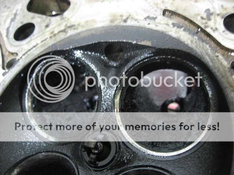

Sea Foam Clean Ports while head was still fully assembled VS. Un Cleaned Ports
As you can see from the pictures a Sea Foam Treatment Service to clean the cylinder head / valves only works to an extent ! Cylinder head is currently being steam cleaned, all the valves will be fully cleaned and re installed with new Valve Guide Seals.

Well this shows seafoam can clean to an extent but is not an all god carbon build solution as some make it out to be
Exactly ! We do not recommend any sort of Sea Foam Service while the cylinder head is still secured to the short block, as it can allow for large chunks of carbon to both fall into the cylinder as well as get caught in the valve sealing surface with could lead to a valve being stuck slightly open or even worse bending a valve !
