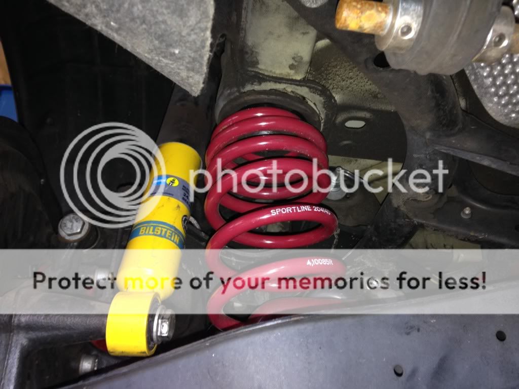

Bilstein shocks
Eibach Sportline Springs
Eibach Sway bars - solid - 26f 23r

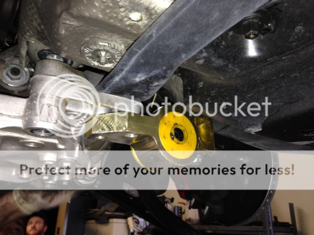

Whiteline Anti Lift Kit
Whitline Rear Trailing arm - front bushing
Whiteline Front Control arm - lower inner front bushing
TyrolSport Deadset subframe kit

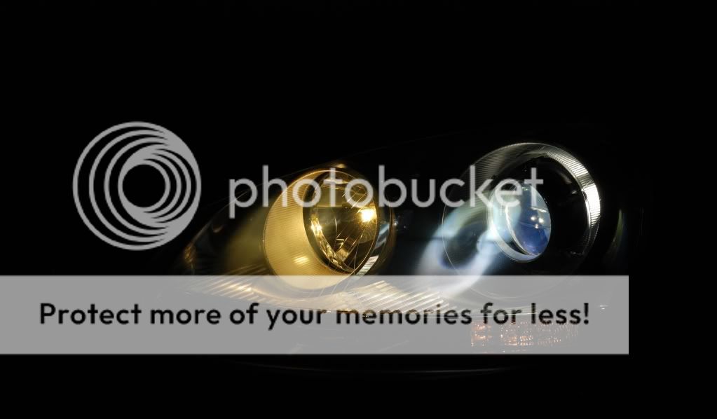

Lighting
FTP mod (FTP now come on with high beam – very bright)
FTP bulbs switched to yellow 2500K Noya
Euroswitch
Morimoto LED fogs
