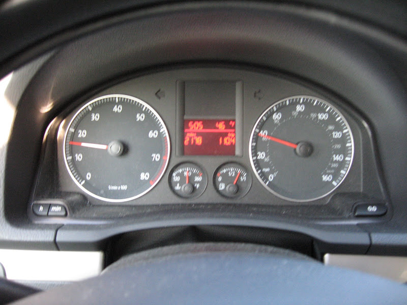

I'm experimenting with ways to increase my fuel economy. I'm getting pretty decent mileage, but I'm trying for better. I've adjusted my driving speed and acceleration rate as slow as I'm willing to do, which is the most important part. I've removed my antenna (which was mainly for another reason) and increased my tire pressure, both of which theoretically can help slightly.
Mainly, my experiments involve shift points and throttle. So far, shifting extremely early and keeping the revs very low make a big difference.
My driving is 40% freeway, 60% backroads/town/rural highways. I measure my MPG by dividing miles on the tripometer by gallons on the pump. The 2 door Rabbit does not have the MFD, so I can't get the car to report it to me.
On my very first tank, I shifted in the 1800-2200 rpm range. Including a few hours spent learning the clutch (new MT driver), I got 27mpg.
Then, for a few tanks, I experimented with higher shift points - 2500-3000rpm, 2200-2800, etc...and got between 25.9 and 26.4mpg.
I returned to shifting low, and tried to go even lower. I also sprinkled in some fun by doing lots of passing on two-lane roads requiring lots of downshifting and revving way up, as well as a few hard acceleration days when I was late for work. I got 28.06mpg.
For my latest tank, I tested out a theory I read on the standardshift.com forums. The theory is that you should floor it (wide open throttle (WOT)) and use different shift points to moderate your acceleration rate rather than using different throttle levels. As long as your shifting low you won't accelerate fast, won't create much power, and won't use much gas -- but in the meantime, having the throttle open wastes less energy trying to suck air in through a tiny opening. I am skeptical, not for the usual cited reason that flooring the pedal always means making more power and using more gas; I know that if the engine is not revving fast, it's not going to suck in much air and therefore won't use much gas. No, I am skeptical for two reasons -- one being that the computer behaves differently for WOT than part-throttle (open loop, richer mixture, pre-set fuel tables, etc) and the other being that VW's DBW system might not even go WOT just because I floor the pedal.
Skepticism aside, I did get my best mileage so far: 28.13mpg. However, I didn't do quite as much fast/fun driving as I did in the previous 28mpg tank, so I'm guessing that it's no better and maybe slightly worse than moderate throttle combined with very low shift points. It certainly didn't produce the result I feared, where my economy would dive to <20mpg. It was kinda fun getting through 5 gears in a few seconds time, and the gas pedal makes a strangely satisfying plastic "thud" as it hits the floor.
Questions? Comments? Suggestions?

Ive heard that theory. But if you think about it, do you realize how much stress you put on your engine? Going WOT in a high gear at low RPMs, yea thats quite a strain.

A lot of people mention the stress thing, but I'm not sure why it would be particularly stressful. If you're not making a lot of power either way, what part of the engine is getting stressed?
If it was getting a lot of air and fuel, then yes, it would create a lot of power and stress; but at low RPMs, it does not pull much air and therefore does not use much fuel.
So anyway, there is another thing I'm doing which I forgot to mention. I'm not using neutral while coasting; at first, I would put it in neutral as soon as I saw a red light, but now I leave it in gear until I have to declutch. This lets the wheels turn the engine, allowing it to use DCFO (Deceleration Fuel CutOff) mode instead of spending gas on idling wile the car coasts in neutral.

the best i got was 25 mpg and that was when iwas breaking in the engine.
on my phone i downloaded this free program that you put the amount of gallons inputed and the miles driven and it calculates it for you.
my average right now is 23 mpg which isn't to bad.
i never used the ac in my car at 2800 miles :)
even thought gas prices have been high.. i still stomp on it once in awhile.
i have a auto and i always use tip cuz the drive mode SUX!
it shifts when im going uphill.. literally on 5th gear at 1800 rpm going up a hill with no power.....

The average on my Stage 2 GTI is also 23+MPG though. It really shows how inefficient VWs 5 cylinder really is.

Well, the whole point of using a smaller engine + a turbo is that it's more efficient than a larger engine when you're not using lots of power.
Still, the only time my 5 cylinder got less than 26mpg was when I accidentally left it idling for four hours. Don't forget that nate122 has a traditional automatic, not a DSG or MT.
FWIW, the US EPA compares cars scientifically using proper methods to make sure all variables are equal, and the 2008 2.5 gets one more MPG than the 2008 2.0t in city, and is the same for highway. 22/29 vs. 21/29. Those numbers are for their new 2008 more realistic estimates where they accelerate harder, drive faster, use the air conditioner more, and test based on colder outside temperatures...resulting in lower numbers than previous.
nate122, is your Rabbit a 2008? EPA's estimates show an improvement of 3mpg city and 1mpg highway for the 2008 model over the 2007 for the MT, but I didn't check the auto.

i really must have a lead foot, i was filling up every 230-250 miles per fillup (before the gas light went on) but pretty damn close to E, on average that means that i was getting only 15-20mpg

Wow, my GTI /w APR 93 Oct easily gets 31 hwy / 27 cty if I drive it right.

My GTI get 30+ also if i follow the speed limit

nice read up totally something to wonder and think about good work but so far on my 08 CW 5spd rabbit it has about 1500k and im averaging about 22.4mpg im guessing the car needs to still be broken into and the car needs to get used to my habit but even in my 07 i shifted around 3k top only would have to shift at 4k if i really needed too and i still didnt get horrible gas mileage but i've done a trip about an hour and 30 mins away from town i got about 25.7mpg? i believe crusing between 65-70 mph.
holy have you tried pumping the middle grade gas? because even in my 07 i did regular but i've been wondering if i ran a good 5 tanks full on the middle grade maybe since the car is running a bit richer will i get better mileage? interesting.
edit:: my 07 and 08 are both manuals btw so i understand your concept.

Hmm....I wonder what variables could account for the difference in the observed economy I've gotten vs. what you've gotten. Of course, the first and most obvious thought is difference in driving style, but I'm not so sure.
I've only got 4000 km on mine now. When I wrote "my first tank", I didn't just mean the first tank where I tried to keep track; that was the very first time I put gas in my brand new car. Therefore, the issue of breaking in the engine doesn't explain it.
Your '07 would definitely be less efficient, they changed the intake and the chip (and maybe some other things) between '07 and '08, for efficiency and power. The EPA economy estimates went up along with the HP. Still, I would expect you to get ~24mpg shifting under 3k, if you drive the same combination of city/highway as I do.
For your 90 minute trip, did you only make and return from that trip, and calculate your mileage based on that; or did you use a whole tank as normal, which happened to include that trip? That trip would take 1/3 of your tank at an average of 25.7mpg, so if you used a whole tank before calculating, the trip itself could have been over 30mpg.

Originally Posted by BlueWabbit View Post
i just passed on what i got on my average with my 08 2dr there is the MFD
How did you get the MFD on the '08 2dr Rabbit? Was it part of an option package? Mine was the base model and does not have the full MFD.
(Note: If you're reading this, I forgot to insert the photo. Damnit.) (Edit: Oops, sure enough, I forgot. Well, I'm still waiting to download it from my home computer, I don't remember which one it is so I have to download a few hundred megs to look for it before I can post it. I'll post it later.)
Anyway, the MFD is reportedly not at all accurate, but I wouldn't know.

Okay, as promised, my '08 2 door base model Rabbit's Fewer Function Display...

no idea how i got the MFD but i just do haha on my 07 4dr though it did not have the MFD so i dont know what is the case there but if you say it is not accurate well damn all this info i've been saying could be false xP (well the average mpg anyways)
