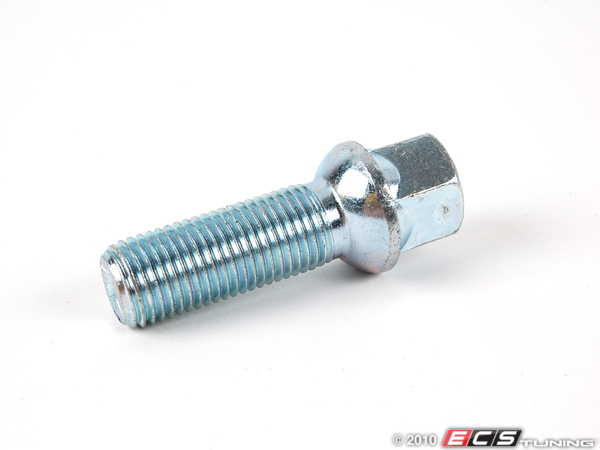

You should get some 35mm bolts for them.

You will need to run 14x1.5x35mm lug bolts paired with those 8mm spacers -
