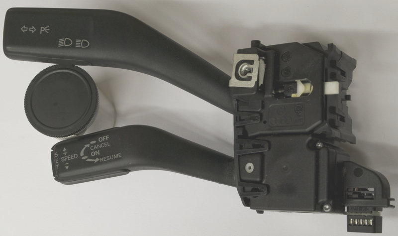

I tried bumping an old thread with not much help so I'd thought I'd post in the DIY as I'm looking for some help...
My cruise stopped working recently. It happened once before about a year ago; the switch wouldn't turn on my green cruise light. After turning the car off and back on, it started working again.
Now, it doesn't work at all. Also, I have an APR tune that I cannot switch programs. I've read that the stalk goes bad, but I haven't really had a confirmation of that. I can't even find a replacement part on ECS, so is this something that I need to have the dealer do?
Any help or even an idea of what this costs at the dealer would be appreciated.

I had the same issue where the cruise control wouldn't work but then I turn off the car and on again and it would work. I had the stalk replaced before my bumper to bumper ended and it seems to work now but I can't say a 100% that the stalk was the issue.

Would not be surprised if your stalk is failing.
Intermittent operation is not uncommon as they go bad.
I use the turn signals religously and am a bit ham fisted at times,
so I expect my stalk to fail eventually.
My mk5 is the first car I have ever owned where the turn signal stock hasn't failed (yet), at 185,000+ miles now.
I was so convinced the stalk failure trend would continue
I bought a replacement from a part out couple of years ago.
I have a 2006 with the separate cruise control stalk
Since I have a spare on hand, I suspect that is why it hasn't failed, no complaints.

Mine is all integrated. I can get a new stalk for around $100 but I'm not thrilled about throwing $100 at a chance of fixing it. I will at some point I'm sure.

Might be the connections inside drying up. I'll dig the link out about sorting it when I get home.

Sorry for the delay. Althought the link is in Danish you'll get a pretty good idea from all the pictures, and google does a fair enough translation if you still want it. Just remember to use contact cleaner.
Clicky
Clicky
Fish
Thank you...I will definately try this!

Thought you guys would be interested to know that I followed the instructions in fishy's link above to dismantle and clean the cc unite in the stock. I've been having cc issues for roughly 6 months now. Light engages but then cuts off or most of the time it doesn't work at all. After cleaning, everything seems to be working perfectly. I'll post updates if anything changes. 07 bpy manual GTI. Once again thank you to the MKV forum and all the dubbers. Without you guys I'd be dead broke and still clueless about this racecar that I am so fond of.

Well this was a pretty simple process, but didn't fix my issues.
The contacts were actually quite dirty, and the whole process didn't take long at all.
I guess its back to the drawing board. Any other ideas out there?
